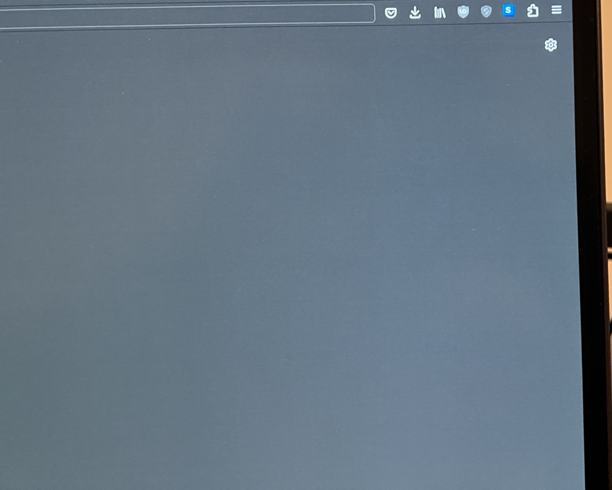

Regarding the burn-in issue, here's what happened to me after less than 20 days of use:
Run Pixel Refresh and give monitor some other content for a few hours -- see how it looks.
I am curious, do you have Orbit turned on? What gaming profile are you using?
I've been doing this all this week but sadly it wouldn't go away, I just took it to a service center and they will replace my panel.
If by Pixel Orbit you mean Screen Move mode, I've always had it turned off by default because it was too invasive, although lately I've discovered that mode 1 was good and not annoying.
I use the monitor in Gamer 1 mode, brightness 79, contrast 70, HDR off, 50% digital vibrance in NVCP, taskbar disappeared, dark theme in Windows and Chrome, automatic screen lock after 3 minutes.
That circle looks like a minimap, I play a lot of competitive fps with a static HUD.

Chief Blur Buster wrote:
20 Apr 2023, 14:42
CortexFPS wrote:
20 Apr 2023, 10:32
After reading this post I checked my screen and noticed an identical circle outline on a different part of my monitor. In the picture I attached it's right below the download button. I'm not sure if it's a coincidence but my outline is also more promiment on the upper half. For me none of the games I play have any HUD parts that fit there. The worst offenders (in terms of hours played) would be Escape from Tarkov or Apex Legends and neither have a circle in that area. I also use my monitor for work but at a low brightness (50 to 70) and I don't think any of the apps I commonly use have a small circle around that area (GitHub, Teams, VS Code). I just got my first pixel cleaning after 500 hours of usage and I do multiple image cleanings a day. I really doubt this is a burn-in issue caused by my usage. Maybe some weird uniformity issue?
Anyway I can only see the outline on a grey background. White, red, green or blue doesn't really do it.
