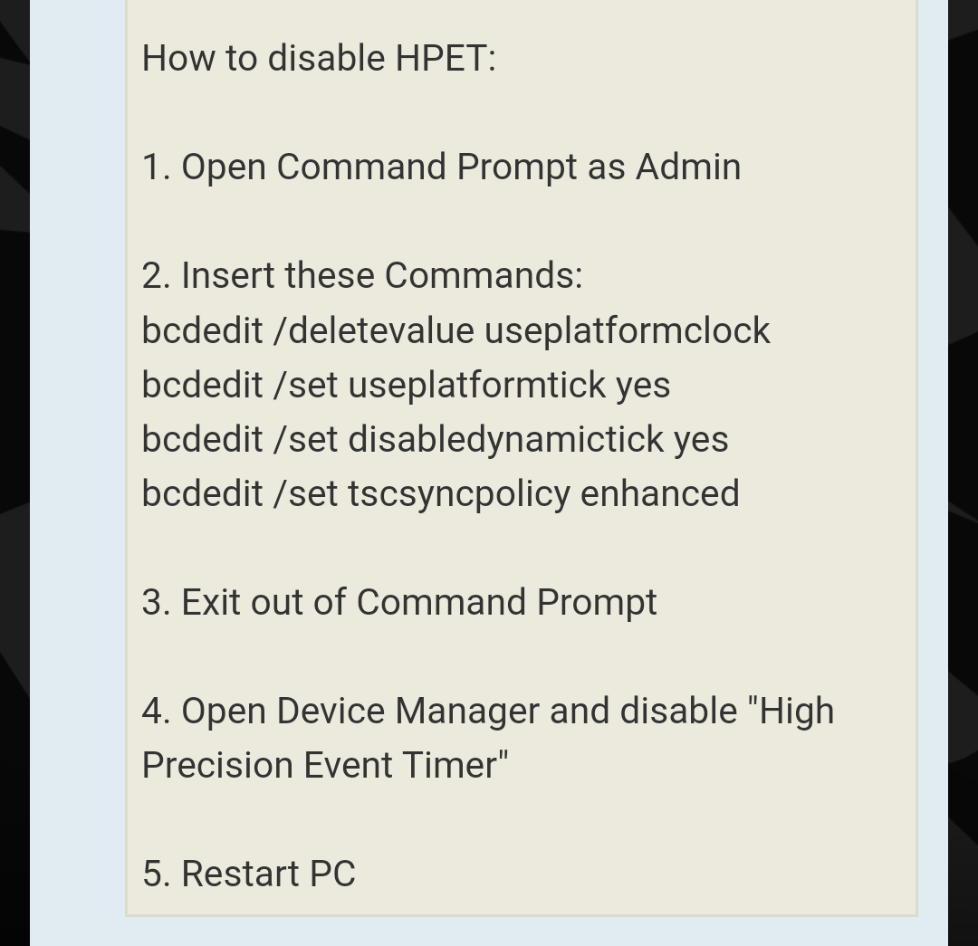

one dude writes to turn on the hpet, for some reason you need to turn on the RTC tick (usetick yes), why?
https://sites.google.com/view/melodystw ... et-tsc-pmt
I think you mixed something up. This is a Post for turning OFF Hpet, not turning it On. I only showed someone in here, how to revert back to stock HPET Settings, if this Tweak didnt help for him.
really?

If you know, using 'bcdedit /set useplatformtick yes' you simply force the system to use a different timer then High Precision Event timer. Its not HPET, as you claim it to be.
As for the website you posted, I can't really seek any usefull Information out of that.
By applying 'bcdedit /set useplatformtick yes', the system will use the Platform Timer rather then the High Precision Event timer. I must say, this is better for older Systems and older applications. In the worst case scenario, it won't do any difference.
Without any Timer, the system would actually perform really bad. By using the command, you simply switch to another timer.

I agree about deletevalue useplatformclock
but, im not understand why you /SET
tscsyncpolicy, disabledynamictick, useplatformtick (RTC TICK).
this has nothing to do with HPET.
Why are you doing bad things to people by giving these commands?

'bcdedit /set tscsyncpolicy enhanced' will spread the timestamps generated by the timer more evenly across all CPU cores. The default value will rather choose one core/thread.
dynamictick is actually a stupid old power saving feature from 2012, which as it says, it dynamically adjusts the Timer Clock Frequency, instead of having it consistent and smooth.
Using the Command 'bcdedit /set disabledynamictick yes' could potentially increase Temperatures by a couple degrees. Its not a good setting to use, if you care about power consumption and you are using a laptop, as I told the guy.
I allready explained the use of useplatformtick.
Can you please tell me, why it's bad?

where you find info about tscsyncpolicy?
useplatformtick yes cause perfomance problem on 1803+, it decrease one-core perfomance so high (1/0.5ms), it is not good setting for all.
anyway, these 3 /set commands not provide disable HPET.

Youre right, these commands are not necessary for disabling HPET, but work in hand with HPET/Timers. They should improve CPU Usage and reduce CPU Processing effectively, and thats also why I saw great performance benefits. Of course it depends on the specifik system too.
I will edit my main post and show how to just disable HPET, without dynamic tick etc.
