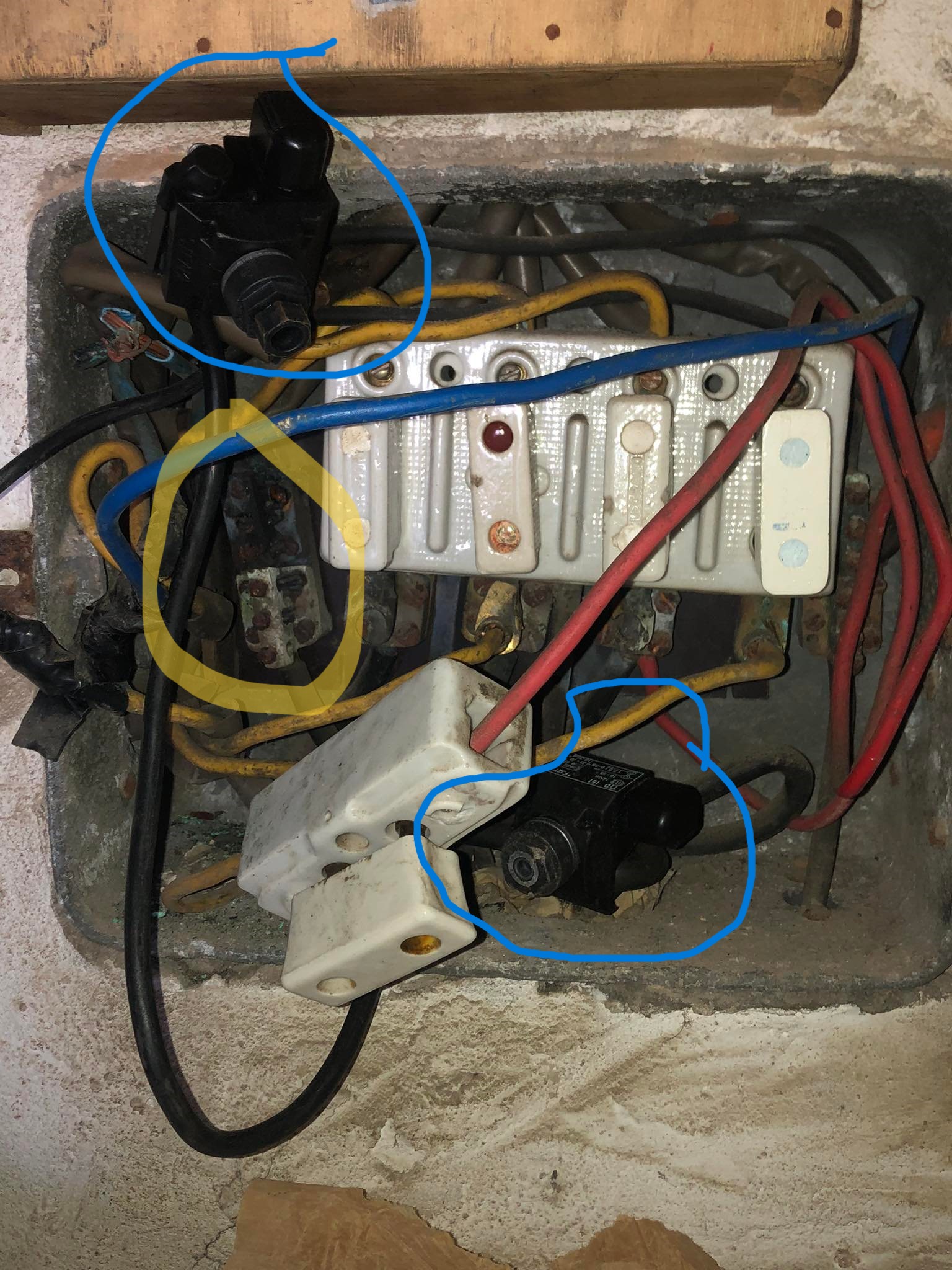

Hello, first thank you for your post, could you take a picture of the installation and what they have changed because in writing it is complicated to really understand and visualize with words when people like me dont really speak english other than via a translator.glorytogod wrote: β03 May 2023, 11:29Hello everyone,

Sure, I understand. No problem. Tomorrow I will show you what they did and take some pictures of the installation so that you can better understand and visualize the changes made.akylen wrote: β05 May 2023, 17:29Hello, first thank you for your post, could you take a picture of the installation and what they have changed because in writing it is complicated to really understand and visualize with words when people like me dont really speak english other than via a translator.glorytogod wrote: β03 May 2023, 11:29Hello everyone,

the electrician told us that the thing marked in yellow is toasted need to be fixed , so he added the 2 black things
- emi1.jpg (597.17 KiB) Viewed 7227 times
