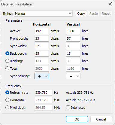

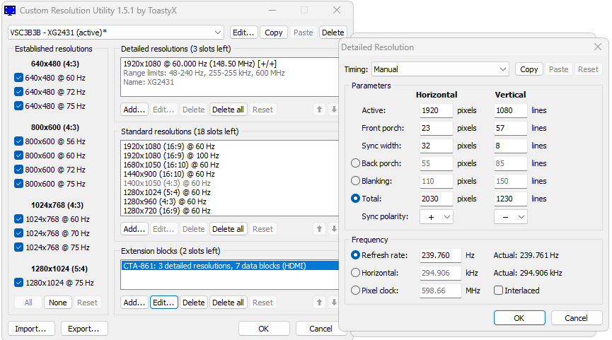

Can anyone share better tweaked CRU profile for 240 Hz? I would like to get max performance out of my XG2431. If there is any way to gain some additional benefits like better strobing or futher improved QFT, could you share info how to do it. In the pictures you can see how my current profile looks like.
Edit.
I didn't get reply yet, but I started to tweak on my own. I had read some blurbusters articles and decicded to modify parameters - Total Vertical. I tried 1160 (factory settings), 1190, 1200, 1225, 1230, 1260 (black screen on system loading - I had to login to windows emergency mode to change value).
What I had noticed so far?
The screen feels like a little more responsive, strobe is better - I can really see the difference in viewsonic strobe utility made by blurbusters. Increasing the total vertical value leaded me to reduce overdrive gain cause ghosting (coronas) became visible at the same settings. I had overdrive gain 39 for 1160 vertical total and had to reduce to 30 for 1230 vertical total.
Waiting for an CRU expert to join coversation and give some tips and explainations
Edit 2.
After a day of investigation and testing many values. I noticed a tiny horizontal line and it is visible above value 1165 Vertical Total .
Today I increased horizontal total by 100 to 2130 and Vertical Total by 5 to 1165.
Conclusions for now, increasing Veritcal Total improve strobing, however there is cost of it, a tiny horizontal line (above 1165 Vertical Total) not visible during normal usage but you can see it in viewsonic strobe utility.
Edit.
Edit 2.
