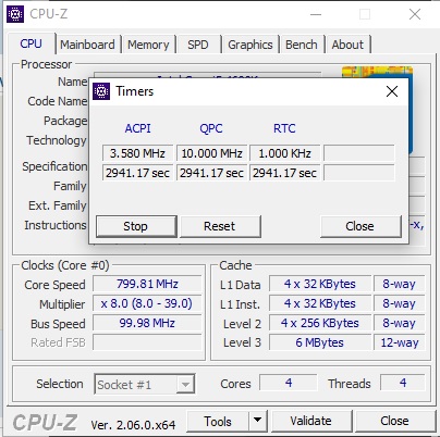

Just found an issue.
Everytime I do restart64, the monitor's audio bits/Hz setting is changed to an invalid setting.
As a result, there is no sound and VLC crashes trying to play an mkv.
I need to change it everytime.
Also noticed that when Windows boots, the cpu-z timers tool shows the RTC is slower than ACPI and QPC.
But when I run restart64 at least two times, it will be in sync with the rest.
try to repeat this test without nvidia driver (disable gpu in dev.man.)
im need more info about RTC, bro
always after 2 reboot or it can be good on startup without reboot, or maybe 1 reboot fix that?

Post by MatrixQW » 03 Jun 2023, 16:12
At boot, RTC will go out of sync.
Seems that even even when I run restart64 two times it sometimes goes out of sync. It behaves erratically.
I ran restart64 like 3 or 4 times and left cpu-z timers tool running for 5h and it was good.
Windows is using TSC so I think I will just forget about this or I will go crazy trying to find out what causes it.
