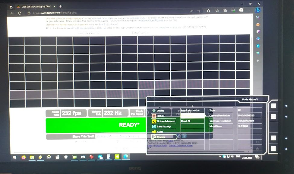

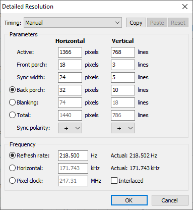

Ok. So I installed CRU (thanks ToastyX) and tried increasing backporch at different resolutions. Sadly resulting image seems worse, more washed out for sure. Lowering it doesnt help. Offset is there too. It's also harder to test since i have to reboot every time and there are only 4 slots.
Honestly I don't know what I'm doing and considering having it as is. Example resolution attached.

So I did more testing and so far best results(colors+artifacts wise) are at the lowest back porch before screen doesnt respond. See attachment. Total refresh rate seems to be major factor, while intervals are in "work or don't" mode.
Also maybe theres some food for thought here: it only works like this in scaled by GPU mode but clearly all monitor's pixels are lit. Possible to hack it into producing 1080p at higher clocks somehow?
