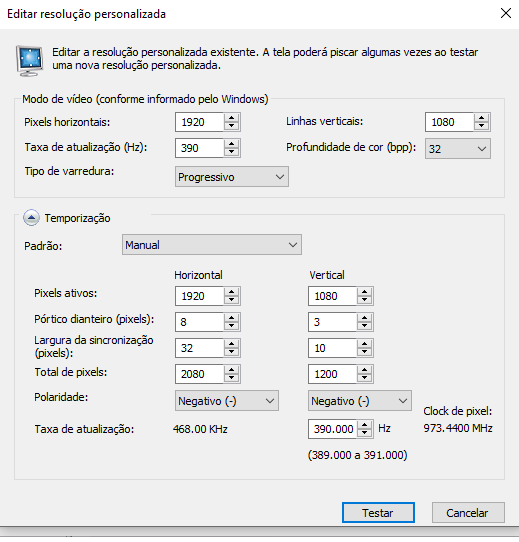

Do you know if it would be possible to get the original timing of this monitor at "native" 390hz?
Are you asking this because you are currently using a a custom resolution?
If the answer is yes you can either delete the profile in the Nvidia control panel (if you created the res in NVCP) or click reset-all.exe followed by restart64.exe if you used CRU.
If the answer is no, the monitor should automatically show the native 390hz resolution(390.30hz with my unit) displayed by the EDID but this is only present if you enabled the Overclocking setting. If it doesn't work you should try to reset your monitor settings in the OSD.
I'm asking this because unfortunately my XV252Q unit flashes with "native" OC 390. But using the trick of creating a custom resolution in NVCP, at 390hz, with manual timing it stops blinking immediately. The trick is to turn off the "OC" on the monitor, forcing it to go to 360hz, create a custom resolution in NVCP of 390hz with manual timing and apply, and after that turn on the OC in the monitor's OSD again. But I'm afraid I'm losing some kind of performance compared to using native 390hz, such as input lag, blurring or any other problem that could be added that way, could you tell me? Anyway I'll post a print of the times I'm using in NVCP in case you can help me. It seems that the game is a little worse this way than using the "native" 390hz monitor, even with non-stop blinking, despite having tested it for a short time, I think it could be a placebo.

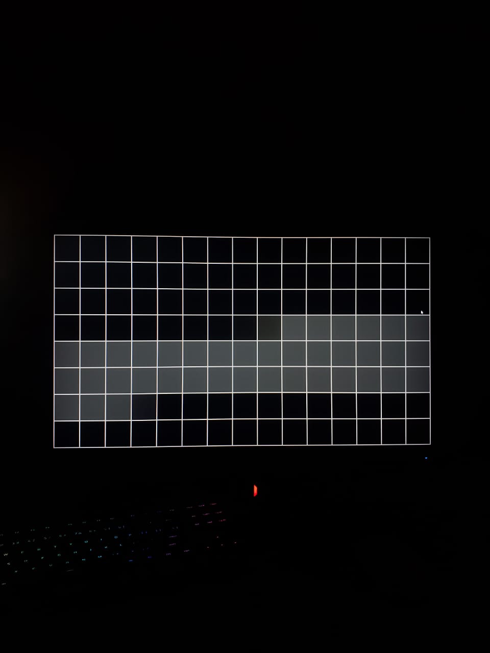

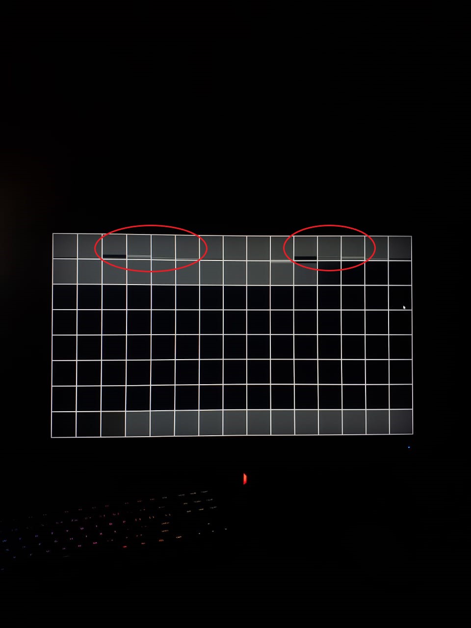

I also took some pictures of the frame skipping test, some come out perfectly, but others come out with some "cropped" frames? Would that be a problem? What can this be?
Maybe Chief can shed some light on the cropped frames, I don't think that your monitor is frame skipping since there's a visible frame. It's probably a browser issue.
