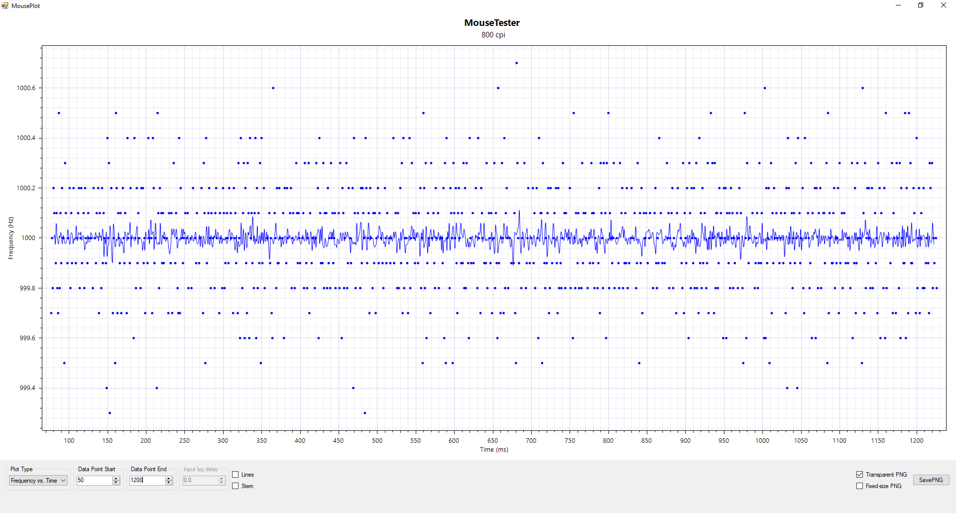

Hmmm thanks I might try that out.
Even removing every single usb and leaving only the mouse doesn't get me stable polling.
Is it better to use chipset or cpu usb ports ?
Did your problems get resolved when u achieved perfect mouse graph ?

widow13 wrote: ↑
17 Aug 2023, 12:17
Slender wrote: ↑
17 Aug 2023, 11:21
widow13 wrote: ↑
17 Aug 2023, 10:08
Also do u recommend buying a pcie usb card ? Would it help ?
and if yes. Any good recommendations ?
im tried only via and nec (v1/v2) 3.0 board.
All have jitter, it good controllers to move dac, mic, keyboard, and use motherboard usb for mouse only.
But im use usb 2.0 pci fard on mcs9990 chip. It dont have msi mode and have more isr then usb 3.0 pci card 5-10 vs 0.5-1 but this controller have clean graphs + no jitter.
+ (im not sure) mcs9990 dont have interrupt moderation.
no, my gameplay is very smooth, but i have same weird responce and feel like my mouse is heavy.

Post by widow13 » 17 Aug 2023, 12:21
Slender wrote: ↑
17 Aug 2023, 12:19
widow13 wrote: ↑
17 Aug 2023, 12:17
Slender wrote: ↑
17 Aug 2023, 11:21
widow13 wrote: ↑
17 Aug 2023, 10:08
Eh, I have the same issues,feels like desync too. I guess achieving perfect graphs is not guaranteed to solve my issues, might have to try my pc on different house too.
