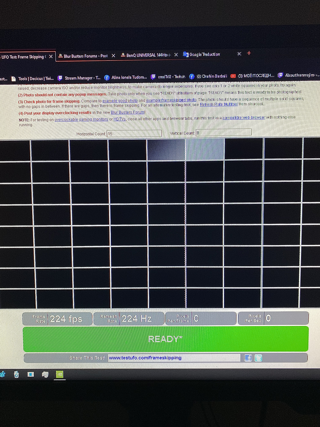

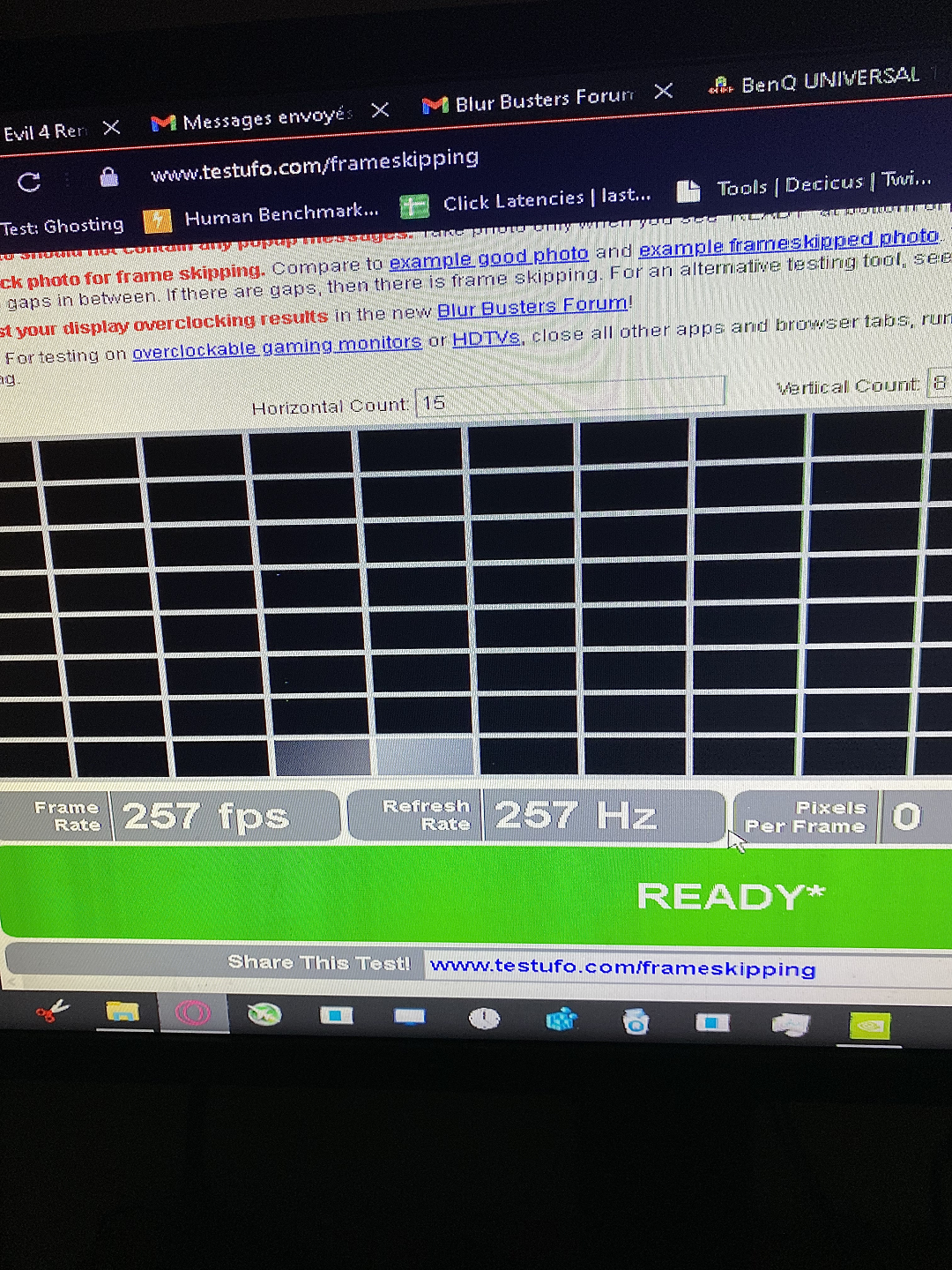

For about two years now I've been trying my best to reach the maximum refresh rate, so here are my results.
Monitor: XL2411P with Displayport / AMA: Off / Instant Mode: On / Blur Reduction: On-Off.
1920 x 1080: 224 Hz
1024 x 768: 257 Hz

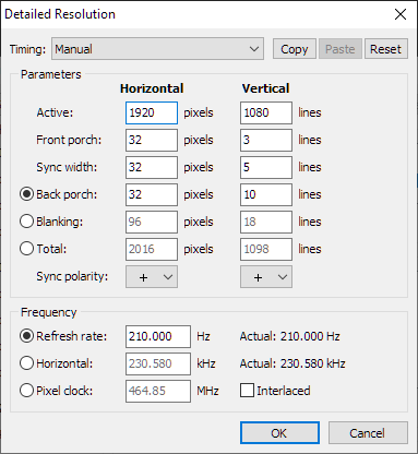

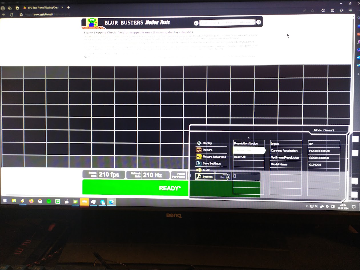

So I had some freetime and tinkered some more.
And I guess Santa had me on the good boys list since just by trying to change all the settings possible I got rewarded:
Disabling AMA and instant mode (as opposed to newer models and 1st page guide) allowed for having high OC at 1080p.
And colors are much better in this mode too!
Lessons here: trust but check your shit anyway and be a good boy.
Also does anyone know how much input lag i loose with instant mode off? I tried to test but 120fps slow-mo shows no difference for mouse pointer movement vs mouse movement at different resolutions and refresh rates. And I don't have a better cam.
