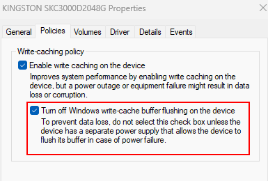

You can even lower more when you check off certain options of the SSD's
2023-11-02 16_04_35-KINGSTON SKC3000D2048G Properties.png (12.46 KiB) Viewed 13155 times
YEGODS DO NOT DO THIS you will lose data and possibly corrupt your filesystem. This option is intended for use on computers with HBAs that have those huge supercapacitors built onto them - you shouldn't do this with consumer-grade NVMe or SATA SSDs.
