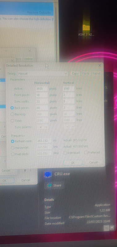

This is how I try to make the resolution
This is the starting position
When I normally lower the porch settings the screen goes black when I enable the new resolution.

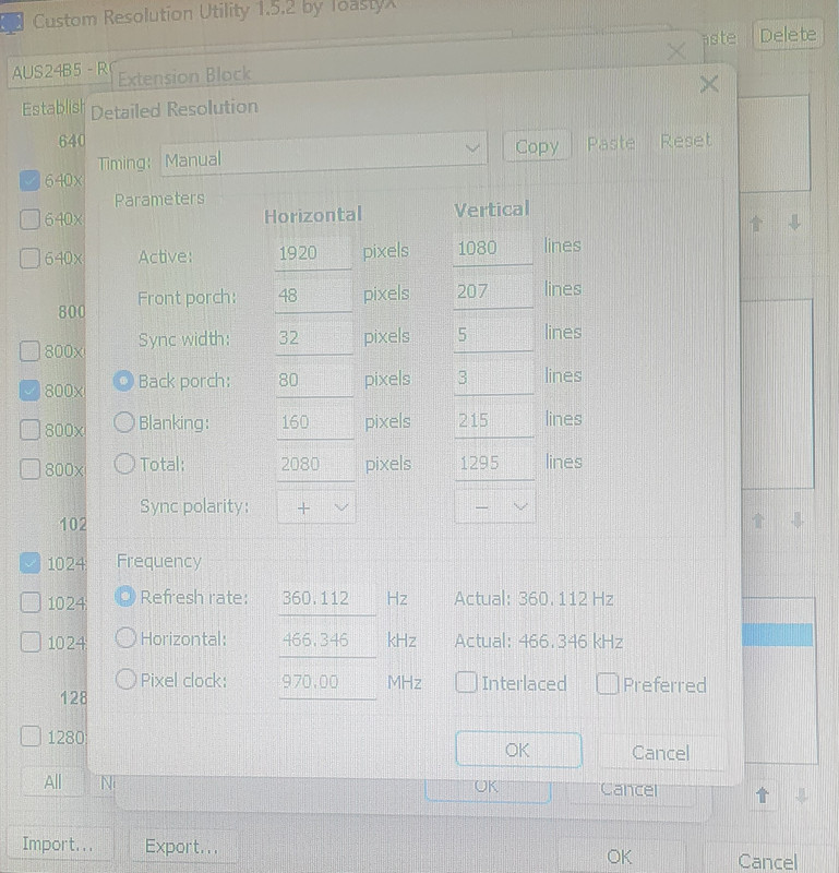

Trying now to keep the pixelclock the same... (970) while upping the refreshrate to 480..

Kept the pixelclock about the same. Lowered the vertical total. Cannot even up the hz to 383hz. The screen go's black.
I am starting to think 480hz on the asus pg248qp withouth DSC is a meme (or even using CRU on the pg248qp is)
