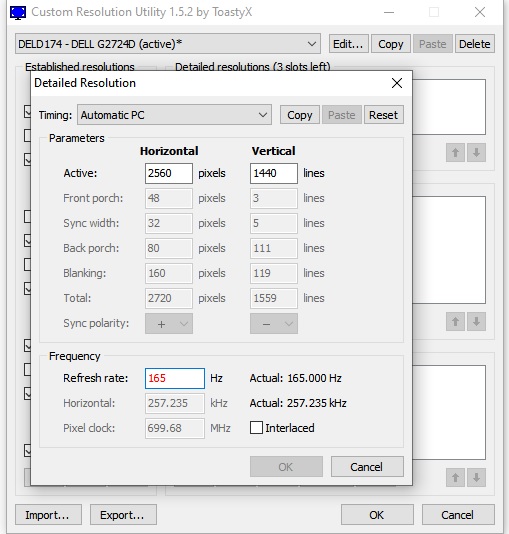

I tried the ToastyX CRU's Vertical Total Calculator - but it didn't allow me to set the 165Hz (it appeared red and I got scared), so I did it with 144Hz -> 60Hz, but without any luck - the artifacts were still present.
