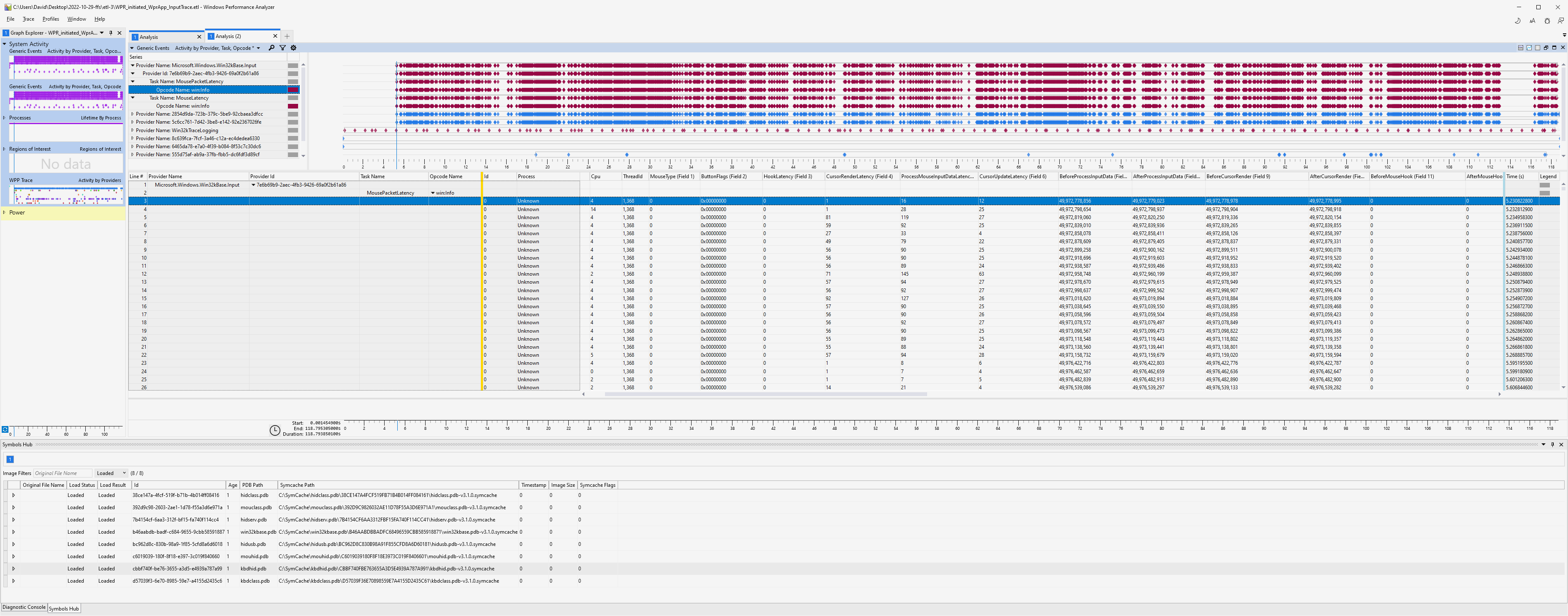

Update: Ignore this post: when I wrote it my mouse-pointer's behaviour was significantly improved compared to before I rebooted, but after a few hours it gradually regressed again :evil:
HOLY CRAP! THANK YOU - your talk of Intel NICs was the lead I needed to investigate things and I then found suggestions to set `DisableTaskOffload` in this thread: viewtopic.php?f=10&t=8993&p=71548&hilit ... oad#p71548 - and that's eliminated about 80% of mouse pointer movement/buffer/latency/smoothness/accuracy issues for me after I've been suffering it for 3 years (I even paid $500 for an MS Support ticket and they couldn't figure it out, grrr - at least I got my money-back), while the issue isn't totally solved, this is a huge improvement.
I've been experiencing this issue for the past 3 years (so for you to have 6 years, you have my sympathy) on *all* of my machines (3 self-built desktops, and my Dell XPS laptop) and I had absolutely zero hint or clue it was the Intel NICs, but indeed: all my affected machines have Intel NICs, including the Dell (and all my self-built machines also use ASUS motherboards, though the Dell one doesn't, but still has an Intel NIC).
My current machine has an Intel i225-V NIC (but in 1Gbps mode).
The reason I say it's only 80% fixed is because there's still some subtle movement issues, especially when moving the mouse at very slow speeeds right after moving it fast (like when moving fast to make a new text-selection then slowing down at the end to carefully select the last-letter of the sentance or something: at that point the pointer would start to undershoot my target, but sometimes overshoot too). I'm still investigating that.
I ran a USB+HID trace using ETW/xperf/wpa/wpr/whatever-its-called-this-year and logged some interesting Windows kernel events that _prove_ that my mouse inputs are being mishandled by the OS and the results I see in WPA when comparing traces I did before, and after, setting `DisableTaskOffload` confirm it - and the "after" results in WPA still show enough latency to matter, I'm curious what else might be causing it.
(Yes, it happens to me with many different makes and models of USB mice, regardless of the mouse's refresh-rate (I default to 500Hz tho). I bought a USB 2.0 protocol analyzer to see what was going on and saw that when my mouse cursor was undershooting my expectations that the host PC was adding delays when polling interrupt IN transfers - and I don't know why.

TooManyPixels wrote: ↑
02 Nov 2022, 15:46
Glad you found my post, btw which felt better to you DisableTaskOffload 1 (nic offloading disabled) or DisableTaskOffload 0 (nic offloading enabled).
Also if you enabled nic offloading do you have some offloads disabled large send offload (LSO), checksums, ip|tcp|udp offloads, and finally your interrupt moderation value (I recommend medium/adaptive on intel)
Can you at least share screenshots of WPA results/graphs/info, others could do the same and compare investigate further.

timecard wrote: ↑
02 Nov 2022, 16:43
02 Nov 2022, 15:46
...unfortunately my celebration was premature. I didn't write my post above until after things seemed good for a few hours - but since I wrote that post (just 2 hours ago) things gradually got worse again and now my desktop's mouse behaves the same way it did yesterday - but it definitely was better after it rebooted.
timecard wrote: ↑
02 Nov 2022, 16:43
Sure.
Clone this repo and run the `usbtrace.cmd` from an elevated command-prompt: https://github.com/microsoft/busiotools ... sb/tracing - choose USB and HID logging in the batch's menus. The generated ETL trace should contain `MouseLatency` and `MousePacketLatency` events from the `Microsoft.Windows.Win32kBase.Input` provider.
...but after that I'm stumped: I don't know how to proceed with the data. I posted a (rather rambling, I'll admit) issue to the repo seeking assistance but I doubt I'll get any there as the repo seems intended for Microsoft's hardware partners who presumably actually know and understand what they're doing far better than any of us seem to do...
https://github.com/microsoft/busiotools/issues/113
As for screenshots:
Both of those screenshots are from the same trace when I'd describe the mouse pointer behaviour as "particularly bad" - I have run traces at times when the pointer behaviour was far better, though still not perfect, (like it was 2 hours ago...) and the numbers are noticably different, such as the `CursorRenderLatency` values all being under 5 (and mostly 1).
