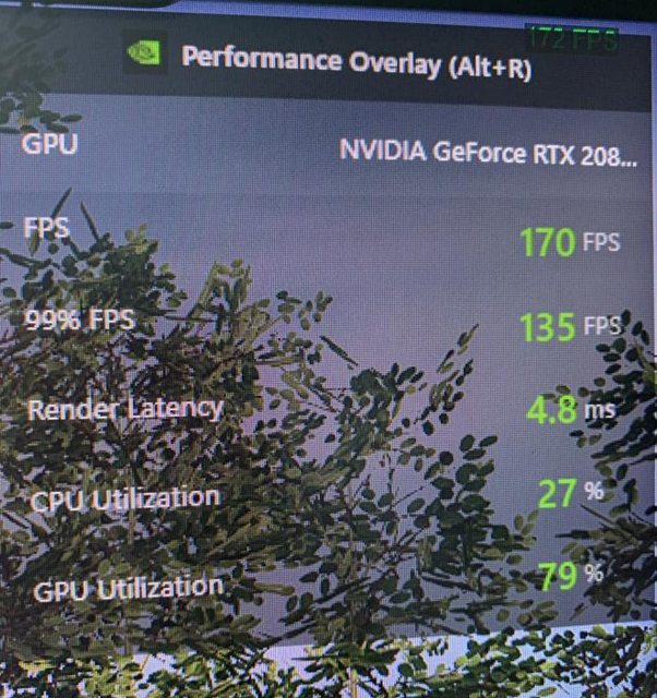

Post by F1zus » 24 Nov 2022, 18:12
AMD graphics cards do not display the game overlay with render latency indicators. Is there any program to measure render latency for amd graphics cards?
