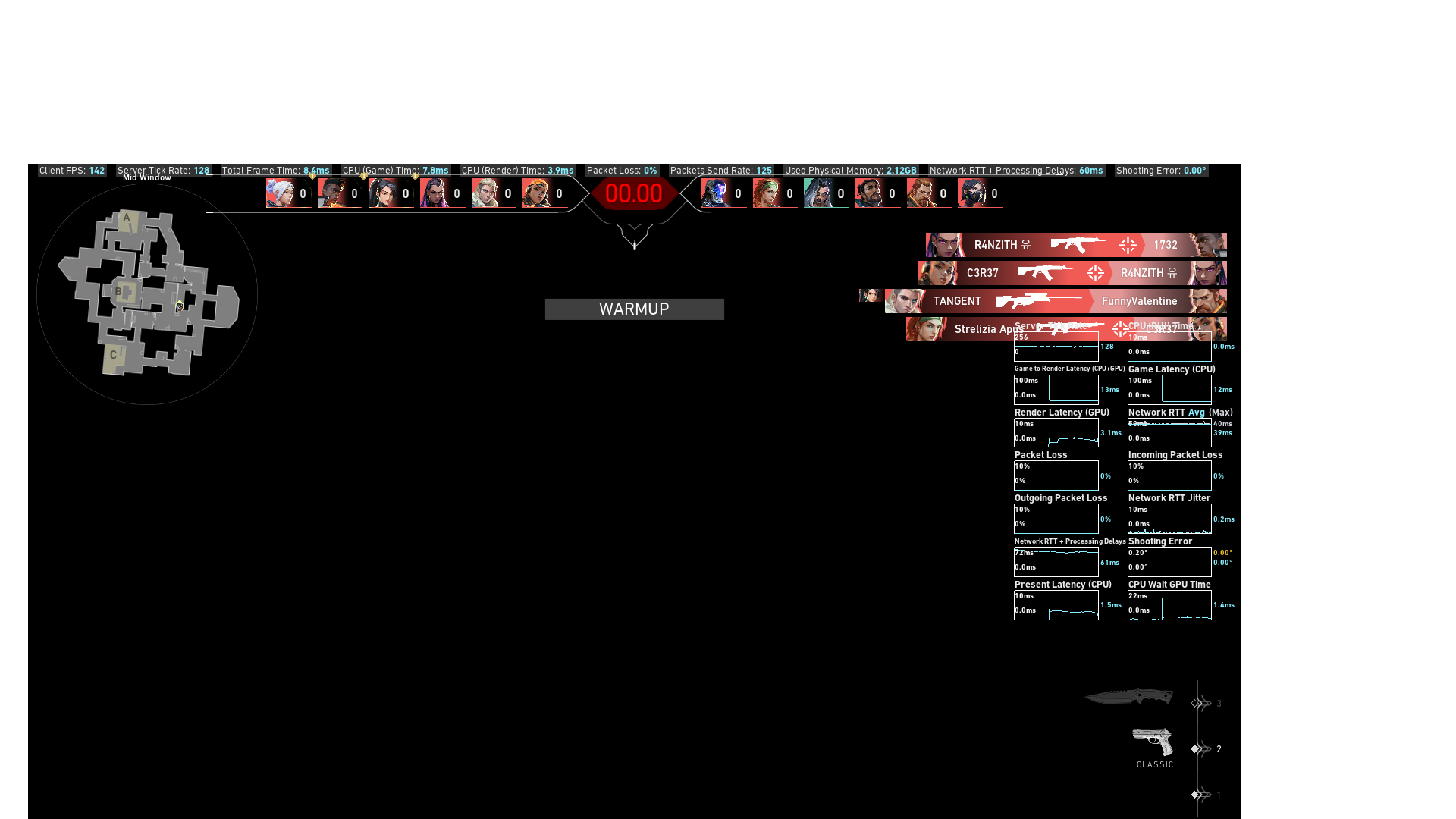

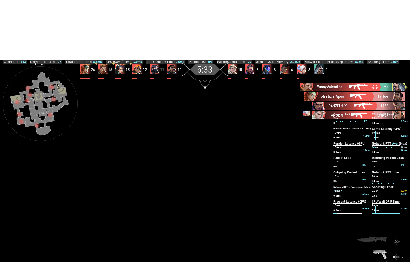

With Rtss Cap ,see latency and cpu wait gpu time at both high around 1.5(it showing 1.5ms cause i am ded else it fluctuates between 1.5-4ms)
Nvcp/in game cap 164 with reflex enable,close to .1ms latency throughout the game
Btw i saw gpu usage(load) it reaches 74% and cpu 60%,i think using rtss is making valorant gpu bound lol(as cpu wait gpu time comes under gpu bound cases)..so bad optimized this game is lol..
Waiting for help.......
