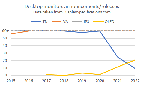

by Discorz
Very exciting!!! The rise of oled monitors just begun.
*displayspecifications.com is limited to 60 samples per search

Discorz wrote:
05 Oct 2023, 09:30
I agree.
I've got a lot of OLED computer monitors here of several different brands, and it's OLEDs' time to shine.
360 Hz and 480 Hz are going to come in the next year and two.
After a long time of OLED never coming, it's finally here.
- TN launched in 2009 and high Hz stayed TN for years
- OLED launched strong, you can't get desktop OLED for under 240Hz, you can't get desktop OLED without HDR
- WOLED (not AMOLED like phones) now outlasts some LCDs in longevity (RTINGS LCD Degradation, new November 2023), so the OLED burnin chickenlittling can bleepinging stop. I Visual Studio 70h/week on my 1.5 year old prototype Corsair Xeneon Flex DVT, and no burnin.
LCD is lovely too for their uses, but the Desktop OLED is here to stay as a superlative strobe-free option in this refresh rate race. By the time 480Hz OLEDs come out, they will have less motion blur than LightBoost strobing -- but without needing PWM strobe. Newer strobe backlights are 1ms, but yesteryear was 2.4ms MPRT in LightBoost, more persistence than a single refresh cycle of a 480 Hz OLED.
So, we have a burgeoning Ergonomic FlickerFree motion blur reduction era, assisted by frame gen technologies. Obviously we still need strobe/BFI for retro stuff if we don't want to framegen/reproject/interpolate/whatever the low-framerate materials. And when we want the clearest strobe (e.g. XG2431 + QFT).
