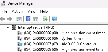

I have AM4 CPU also and your timings are similar. Have you tried turning off HPET? It makes a big difference on AMD CPUs.
Hi mate, do you mean the hpet in bios or windows?
I have an asus mobo and dont have the option to turn off.
In windows by default i don't have useplatformclock in bcdedit, and i've tried with useplatformtick + disabledynamictick but it feels the same for me

There is a device in Windows:
Here's a short overview video on HPET. The speaker emphasizes Intel in the video but I know from experience AMD is just as bad or worse with this setting enabled, and AMD has acknowledged HPET decreases performance.
https://www.youtube.com/watch?v=IBsbAtchZcg
I've read the BIOS setting doesn't matter, but there may be a way to access hidden BIOS settings on your motherboard if you look it up.

I'll retry disabling hpet but it honestly makes no difference for me 99% of the time.
When the problem occurs the game even feels choppy, like it's stuttering.
I just don't get why it occurs randomly.
