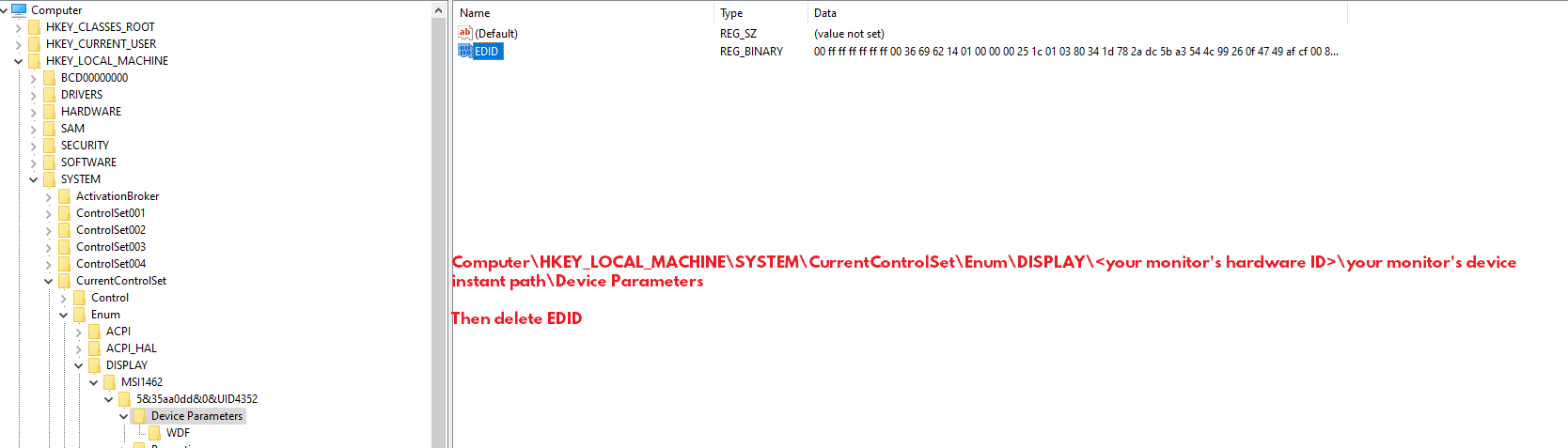

Your monitor driver should still be disabled after the restart however windows re-initiates the driver's folder in the registry every boot. Even though the driver is disabled/unloaded windows re-initiates the monitor's EDID on boot which is what's causing the fix not remaining consistent for me.
This entire DISPLAY folder gets re-initiated on every boot even if you click uninstall in device manager instead of disable (uninstall in device manager deletes this entire display folder but it reappears on pc boot)

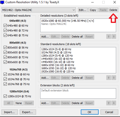

Step 3- Delete the EDID entry in the image above. It can get pretty annoying to navigate to this every boot so what you can do instead (this is what i prefer to do) is using Custom Resolution Utility to delete the monitor profile.
After deleting that profile, it should delete the EDID entry in regedit. If you try to reopen CRU after deleting the profile it should display an error which reads "No displays found in the registry"

I didn't notice any significant difference by disabling the monitor driver. Probably because I have made changes in the CRU and kept only one entry for the 1080p resolution in the detailed resolution section.

Im using this tweak like this; i get the timings from cru and put them in to nvidia custom res and disabling my monitor on device manager.

Tested this quickly by adding a random custom res of a unique dimensions (1750 x 950) to both CRU and then via nvidia control panel. The CRU one gets deleted every EDID clear obviously but it remains applied if the EDID is deleted after the custom res is applied during the same boot, on restart it re-initiates a new EDID which clears out the custom res.
The same custom res made via nvidia control panel remains even if EDID is deleted or not and the fix still works and feels smooth for me at 1750 x 950. So basically if you want to run a custom res set it via your GPU driver's control panel instead of CRU directly (Just as Lev1n mentions in the previous post). Unless you want to keep applying the same custom res in CRU every delete and boot, requiring you to delete it again :cry:
