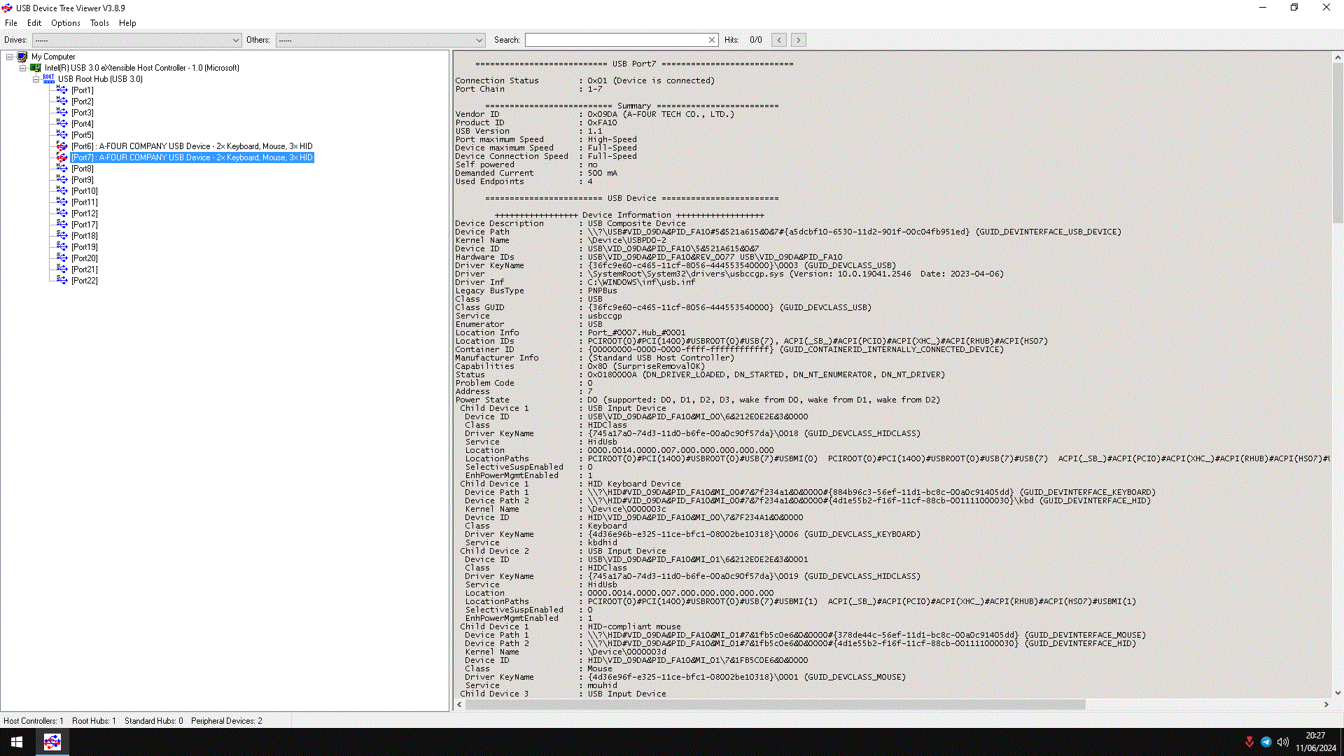

So do i,but i if @MatrixQW decide to respond ,maybe if he sees the screen i upload, he will able to tell if my mouse is running in full speed in usb 3.0 port with XHCI hand -off disabled in bios.
Asus MB btw.

This is exactly what i am trying to understand,thats why i upload a screenshot with the program "USB Device Tree Viewer" so everyone can see if disable it makes my usb 3.0 ports behaive like 2.0 or not. but no one can answer that.

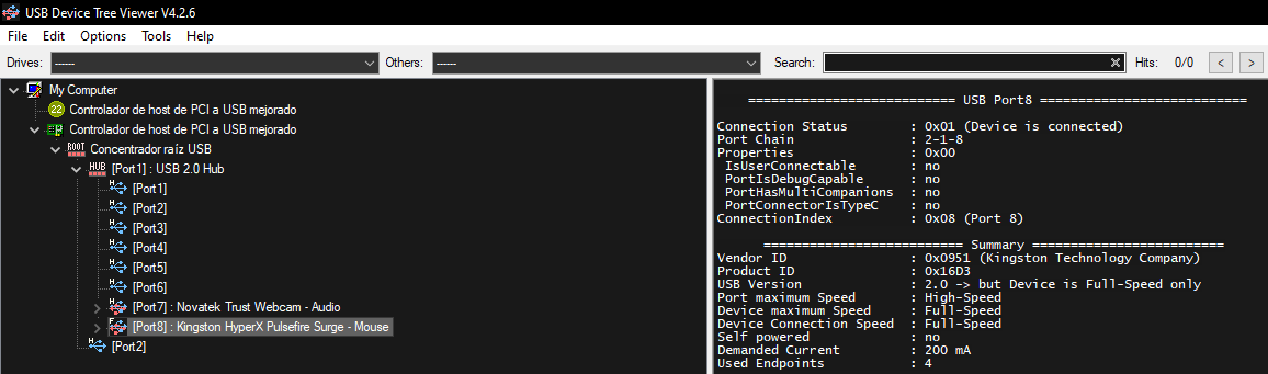

Post by MatrixQW » 08 Jun 2024, 18:43
JimCarry wrote: ↑
06 Jun 2024, 20:56
MatrixQW wrote: ↑
06 Jun 2024, 18:57
JimCarry wrote: ↑
06 Jun 2024, 12:48
So in the end disabled or enabled?
I can't be sure but it seems to me that it will depend on how the setting is implement on each board because of Slender and RealNC contrary statements.
Some boards clearly say that enabled means it's for an OS that doesn't have hand-off support so it works as a compatibility setting.
In this case it should be disabled for W10/11 but even if it's enabled, devices will still work properly at the corresponding speed.
However, for Slender's board it has an effect.
So, disable it and if your devices still work at proper speed you might as well leave it disabled. This is my take.
You can use 'usb device viewer' or whatever app to see the connection speed of the devices.
i think you mean this program but i dont know where to look right now is disabled in bios?
USB version: 1.0 = Full-Speed ; 2.0 = High-Speed ; 3.0 = Super-Speed
You need to look at the "Summary" info.
Mice and keyboards can be 3.0 compatible but they only work at 1.0, they don't need higher transfer speeds.
You selected a device that is only 1.1 compatible.
Connect a device like a pendrive or webcam that works at 3.0, not just compatible.
For example, the screenshot shows my mouse is 2.0 compatible but only works at Full-Speed.
Since I don't have any 3.0 devices for now, I simply disabled XHCI in BIOS.

i dont have any device except mouse and keyboard,but i will turn on xhci in bios and then upload screenshot to see if there is diffrence.
