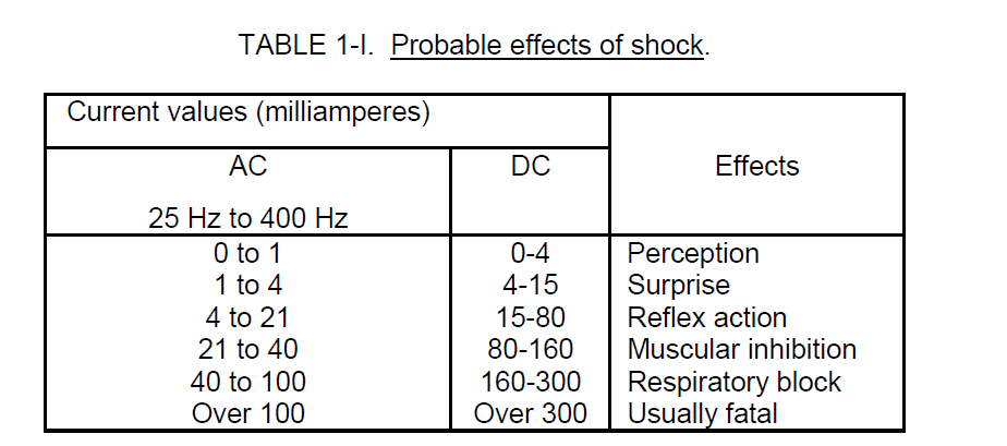

Look here what I found! (see the pictures) These piece of **** TN-C earthing systems...
I just bought the earth leakage clamp meter. It measures down to 0.1 milliamps. I have a different clamp meter but it does not measure this low.
There should be no current on the water pipes. This (88 mAmps) is a dangerous amount of current.
Now I have to call the electrician myself...
Anyway I hope you will be able to solve your problem somehow.
Table of shocks
Table of shocks
88 milliamps of  current on water pipes, bathroom
Bathroom water radiator

Post by cybepine » 02 Sep 2024, 11:12
I do not have any issues with my computers or with audio.
I just wanted to post these pictures for you and other people. So you know what to do and if these help in any way with your problem. (e.g. when the electrician comes).
This (my) issue is a health hazard, because it is in a wet room.
Good to hear that you fixed your problem partially.
But it seems to me that you may have some pretty big problems with your electrical system. You shouldn't have any issues with anything if everything is properly installed and serviced. In other words, no zaps or audio deterioration.
Also if everything in your house wiring is in good order, it should not have any effect. Even if you have installed ceiling light fixture or not.
