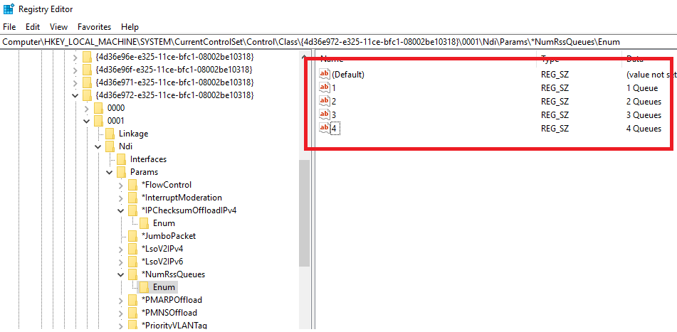

@Slender I think you forgot one step, you need to go on this folder and create the strings for the RSS Queues (if they not there)
my driver have 4rss by default (i check this in wpa, it 100% correct).
