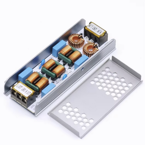

If you look for EMI filter on Aliexpress or Ebay, you should see something like this:
You can try these cheap EMI filters to filter powerline noise. But powerline noise is not that important if you are filtering 12V rails with good combination of Electrolytic, Film and Tantalum Capacitors. Also active compensation techniques improve 12V ripple levles very significantly.
In this thread, I am worried that Electromagnetic field created by PSU cable can induce a 10+ milivolts of noise on nearby conductors, thus causing all sorts of problems. This is way after getting a ripple free stable 12V rail.
