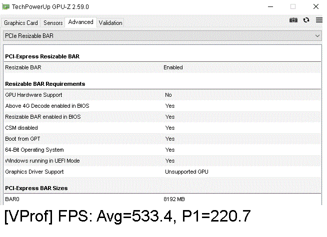

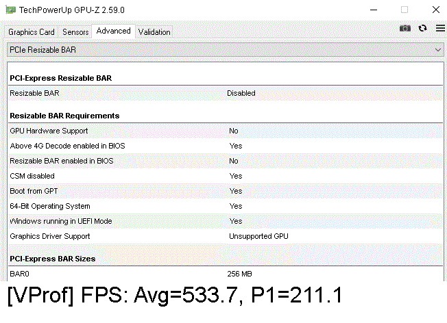

I have pretty much the same settings as you except: i dont see "CPU PCIe ASPM Mode Control" and "PSS Support" in bios,also my Resizable Bar is Enabled.Can i ask why is your audio is not in msi ? also this is my msi what should i change ? and should i disable resize bar?
The settings I mentioned may appear differently on each motherboard. I don't know why my sound is not on the MSI because when I install the driver normally, only my graphics card is in msi mode. I also remove it from msi mode.
The resizable bar causes stutters on AMD systems (including Nvidia graphics cards and AMD processors). When I turn it off, I have a much better gaming experience.
My sound was not in msi mode also i put it,and my vc was in msi just like yours.
can i ask you to run this https://steamcommunity.com/sharedfiles/ ... 3240880604 benchmark with "resize bar enabled and under it above 4g enabled" in bios. and then go in bios disabled it and do the test again.also i have amd cpu and rx 580 8gb but when i disabled resize bar i have only 256mb.Look the screen.
The resizable bar setting does not make a difference in fps in CS2. But it causes a lot of trouble in some games, especially Call of Duty.
I do not recommend the map you posted. Because it gives very irrelevant results. The real test is to constantly check FPS, 1% and Frametime in a normal match.
you were 99% right these is my benchmark before and after.
i have only one question,when i enter the bios i have 3 options:
above 4g decoding
resize bar support
sr-iov support
so if i done it the right way like you said, and in the pictures below, only 4g decoding should be enabled ?

Post by alp15eren » 14 Jan 2025, 11:47
JimCarry wrote: ↑
14 Jan 2025, 11:41
alp15eren wrote: ↑
14 Jan 2025, 11:15
JimCarry wrote: ↑
14 Jan 2025, 11:10
alp15eren wrote: ↑
14 Jan 2025, 10:58
above 4g decoding
resize bar support
sr-iov support
I think there will be no problem this way
