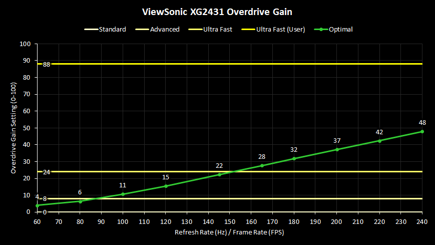

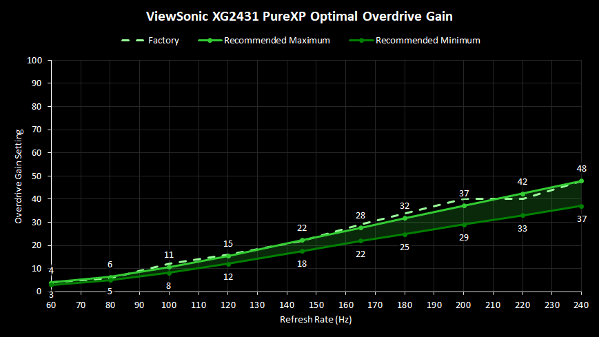

On XG2431 sample & hold (PureXP OFF) overdrive tuning is separate from PureXP ON.
Normally monitors hide 64/100/128/255-level overdrive for fine tuning, but for some reason manufacturers provide very few of those to end-user. I believe XG2431 is 100. Blur Busters does it right and takes full advantage of it for PureXP. For the 4 PureXP presets overdrive is automated. It does a very good job across the refresh range. The Custom presets unlocks all the 100 levels so users can pick themselves manually. But also using Custom means you'll need to do other parameters yourself too.
PureXP OFF overdrive:
- Standard = 0/100
- Advanced ≈ 8/100
- Ultra Fast ≈ 24/100, Ultra Fast (User) ≈ 88/100
PureXP ON overdrive:
- Light/Normal/Extreme/Ultra = automatic (factory dashed line)
- Custom = customizable
In case u want to try QFT or wonder what are the optimal settings, check this spreadsheet.
