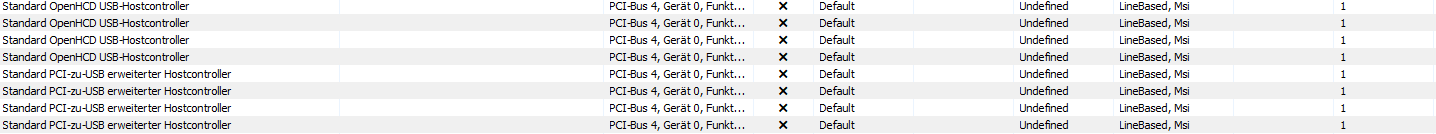

ok I bought one and testing right now
msi mode on or off?
and have u installed a driver?
only mouse or also keyboard and audio?
Is that light on your device also permanently red? I connected the power cable.
there is only non-msi mode.
there is 8 separate controller inside (4 - 1.1, 4 - 2.0), you can connect keyboard and mice.
i dont use power cable for it.
thats the one I have usb 2.0
and you havent installed any additional drivers?
yes, but i think it work better with csm mode + legacy io latency enabled (scewin setting)
msi mode on or off?
i will try

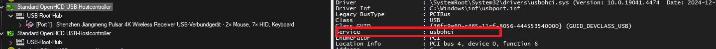

and how to change from ohci mode to ehci?
my mouse is connected to ohci
somehow theres a msi option or does this not work?
i will try
you not need that
that is old like controller
