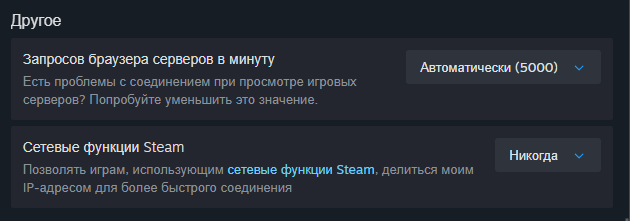

Slender wrote: ↑
18 Jul 2026, 02:35
SammYrai wrote: ↑
15 May 2026, 02:42
@slender I sent you a dm hope this helps
thanks!
I thought I had sent you a message, but I hadn't. By the way, I grounded the router, but that didn't solve the problem at all.
the problem is with this steam setting, you need to put "Never"
