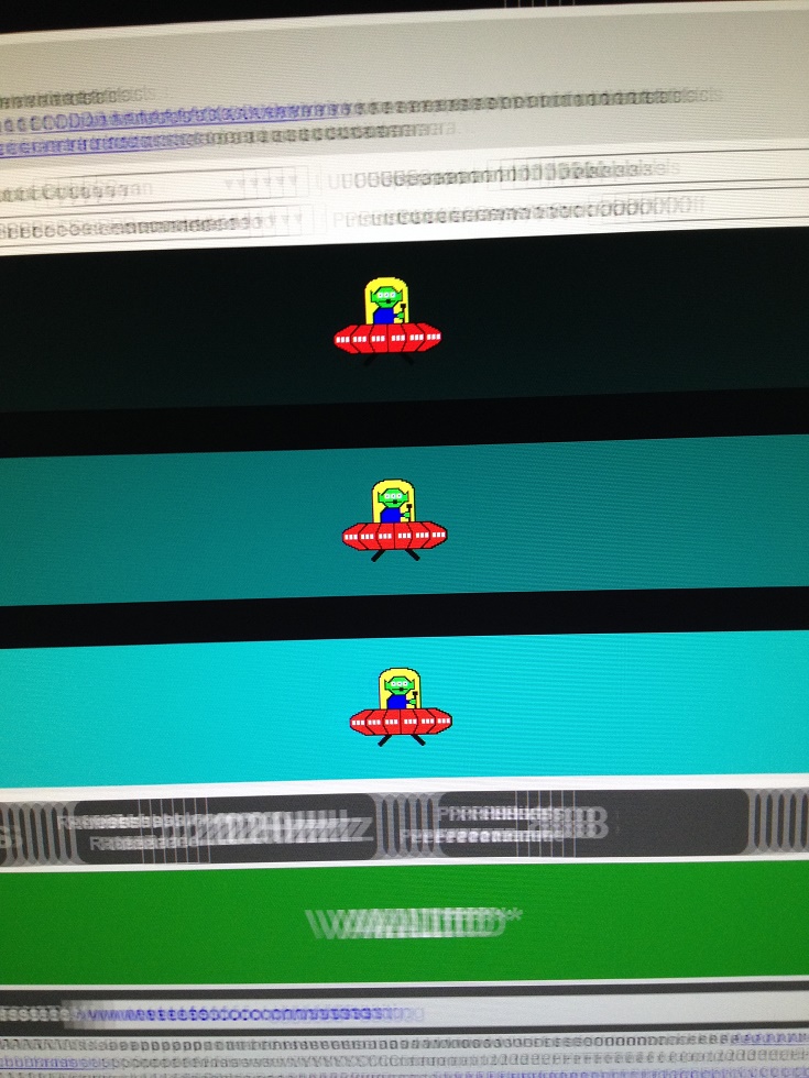

Re: Benq XL2420G G-Sync Chip vs Classic Engine Chip
Posted: 04 Jun 2016, 21:05
by Denonic
Haven't gotten a hold of a DSLR yet but this is the best image I could take with my iPhone of the ghosting. I had to my my hand with the screen but it turned out a bit better than I expected.
This is with ULMB on the displayport. The ghosting is similar to the BBR comparison pics and I've changed settings relentlessly to try and get it looking like yours. Seems like there may be hardware discrepancies in the display chain somewhere.. What graphics card are you using lexlazootin?

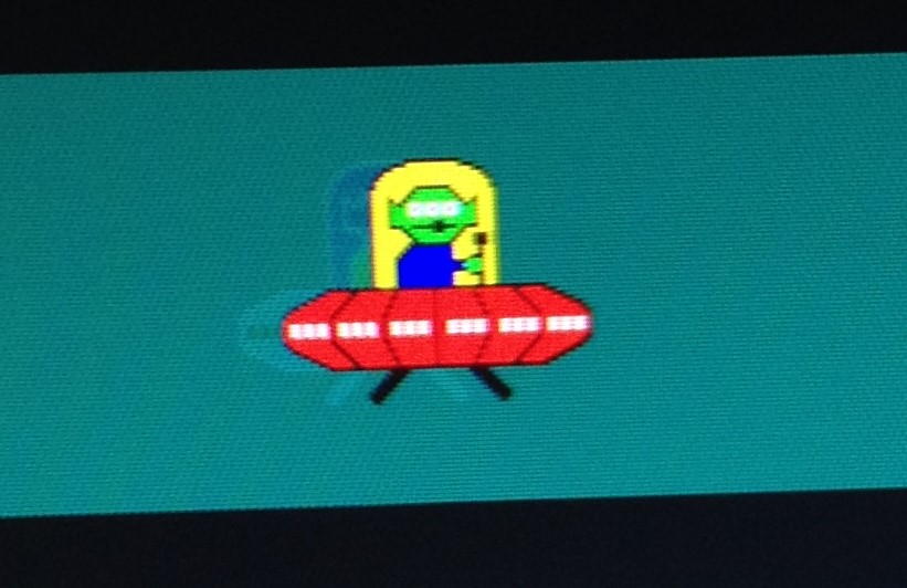

Posted: 04 Jun 2016, 23:16
by Denonic
SUCCESS! I tried it on a different computer, different GPU and it looked completely different with vastly less ghosting.
Plugged it back into my original computer with the GTX670 and it now looks perfect... Lesson learnt.. check cables. Must've not been fully seated in the first place and during replug ended up sitting correctly.
Heres the image after I replugged (still no DSLR but I'm getting pretty good at pursuit shots with my iphone :D ):
Friggin perfect overdrive and motion.

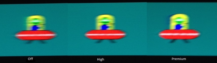

Just for kicks heres an AMA overdrive comparison without ULMB in GSYNC mode @120hz (144hz is probably cleaner):
AMA comparison.jpg (46.82 KiB) Viewed 9897 times
High AMA puts out a near perfect overdriven image whereas the off/premium settings have ghosting and inverse ghosting respectively.
Theres pretty much no reason for me to use the classic mode now as I can't feel the <1 frame input lag difference.
