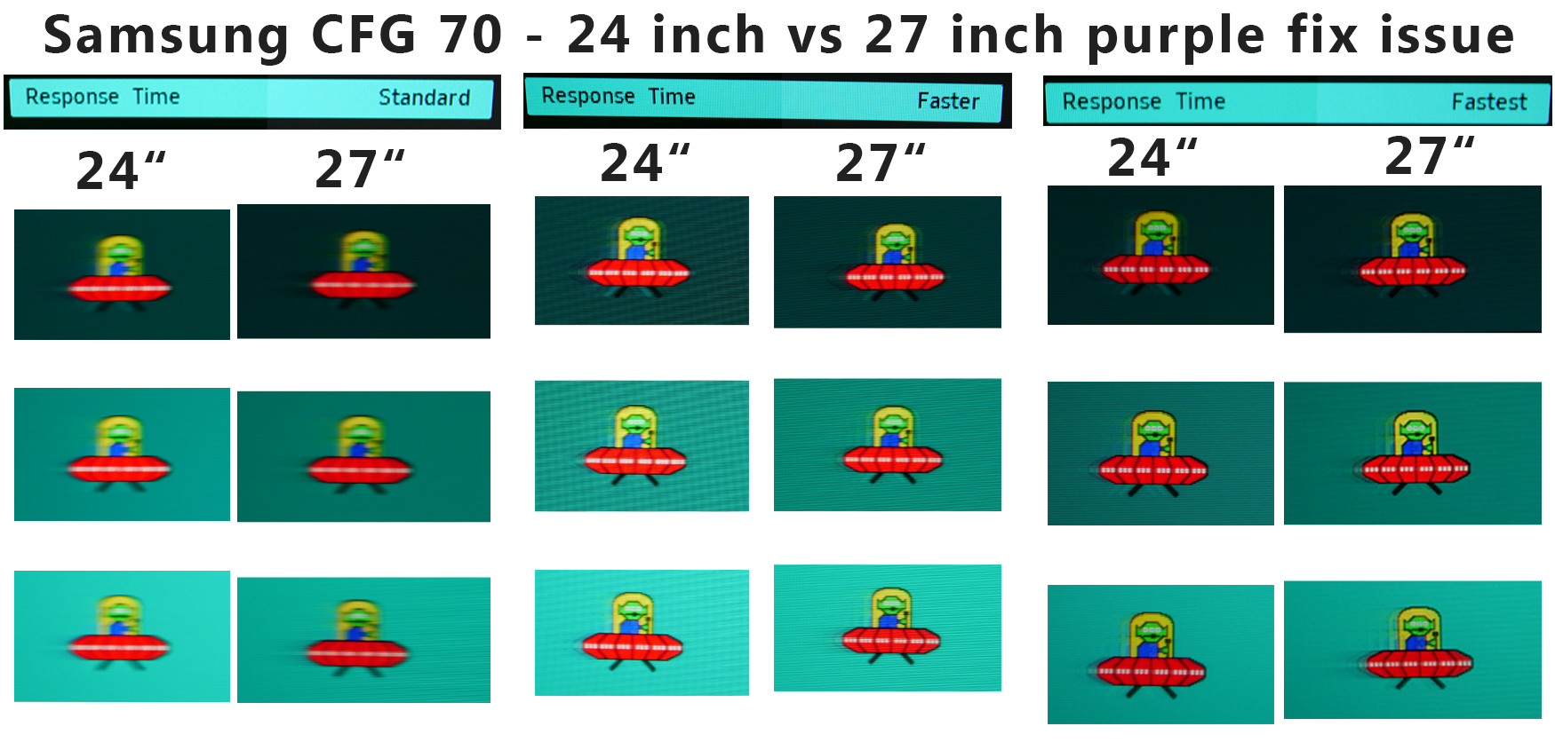

Samsung on fastest 1ms MPRT 144 Hz strobe:
S2716DG 120 Hz ULMB "100 brightness".
You can see the Dell destroys the Samsung. Identical camera settings.
Could it simply be TN>VA for strobe backlight?

I've seen far worse 144Hz strobing. That's why NVIDIA doesn't disable ULMB for 144Hz.
Strobing doesn't work very well with reduced vertical totals. ULMB automatically internally uses (automatically, without user intervention) the equivalent of Large Vertical Totals during 120Hz -- to create a larger blanking interval to have a longer pause for LCD GtG transitions in darkness before strobe backlight flash.
Have you tried Blur Reduction at 120Hz? That probably looks better on the Samsung.
From German site Lim's Cave:
Not sure if that's 120 or 144, but it seems to look better...

Ya 120 Hz didn't look any better. Notice the spaceship white "belt" dots on my samples space-ship smear all the way to the next vertical divider. It's a little more evident in real life viewing. That is a lot of extra strobe-crosstalk that removes a lot of the motion clarity benefit IMO.
I wonder why that German site appears to have a clearer strobing Samsung than me. Also, contrast and "black equalizer" settings have hardly any affect on the strobe cross-talk trailing. As most know, the "brightness" setting is locked out while strobing on these Samsung. Really stupid decision.
