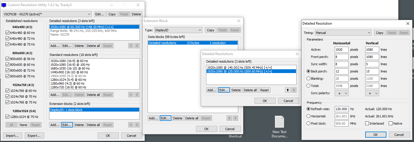

Not sure what am I doing wrong:
NVCP screen on the right is exact copy of instructions from your 120hz low lag trick. It works. But trying the same in CRU doesn't work as it doesn't accept the front porch 1080 trick. Do I need to convert pixels\lines or what?

donnie wrote: ↑
25 May 2020, 11:14
I'm not 100% sure if you must delete the CEA-861 block. something about nvidia and default extension blocks maybe... Anyways I deleted the CEA-861 and added a new DisplayID block. I then added a detailed resolution to the DisplayID.
DisplayID will accept large front porches.
I originally learned this so that I could make my headless monitor run 4k@90hz (There is no monitor it's just a display port connection, with no cable, and and monitor information build it so that you can use any resolution in Virtual desktop, or bigscreen, both VR applications) but I use it now for these QFT resolutions on my actual monitor. The XG270.

New Bitmap Image (16).png (138.59 KiB) Viewed 9815 times
This one shows you that 120hz is possible. The exact timing you are aiming for.

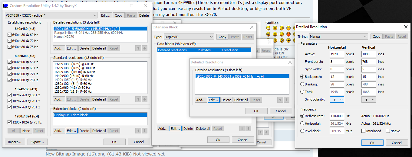

New Bitmap Image (17).png (75.46 KiB) Viewed 9810 times
