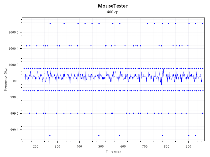

Hey. Could you please specify how you achieved such small frequency variance in mousetest software? Any specific windows version or queryperformancefrequency value?
Most of my systems give QueryPerformanceFrequency() of less than 1 microsecond, currently I'm getting values over more than one million when I use the Windows API QueryPerformanceFrequency() which means I can measure millisecond-scale events on most of my current gaming systems.
This means it's no problem to data-analyze 8000 Hz polls if your computer is recent / configured accordingly. Whether ASUS or MSI or ASRock motherboards.
The main problem is MouseTester.exe requires you to zoom in a lot to see these. Zoom using the very bottom of the graph, and zoom repeatedly until you see the 0.125us polls spread apart. It's a bit challenging to zoom in MouseTester.exe as you have to precisely position the mouse cursor below the mouse graph line touching the bottom of the graph. Then the 2nd or 3rd zoom step is much easier.

yah00o wrote: ↑
20 Oct 2020, 22:43
Those tests are done on windows 7 with properly optimized bios. I wrote a more detailed post on the topic if you want to check that out.
21 Oct 2020, 15:08
Mouse tester (or my version atleast) always has a spike at the very beginning. This can easily be solved by putting 100 in the "Data Point Start" box.
https://streamable.com/smnjmm
My graph is a bit messy due to recording, but should give an idea. Also I personally use F2 to start and stop recording instead of holding lmb since its more convenient.

MT_ wrote: ↑
23 Oct 2020, 13:33
(Still variance of 5us is doable)
5us variance is well below the noise floor of human visibility, fortunately. It's variances that overlap poll intervals that start to degrade 8000Hz quality closer to 4000Hz quality. Smaller variances like that such as 20us or 50us variances (0.02ms to 0.05ms) doesn't make it worthwhile to use Windows 7 instead of Windows 10 if you optimize your Windows 10 system well enough. It's currently far below all known human visibility thresholds of Vicious Cycle Effect (refresh rate race) for likely more than the next ten to twenty years, assuming jitter stays low and stable.
Besides, the Razer 8000 Hz mouse is incompatible with Windows 7 anyway (without a custom driver), but it's plug-n-play with Windows 10
As for client side polling versus host side polling, I don't currently have enough experience with those at the moment -- lack of input devices that has those options -- but it will be interesting to see potential future jitter differences with that when those arrive!
