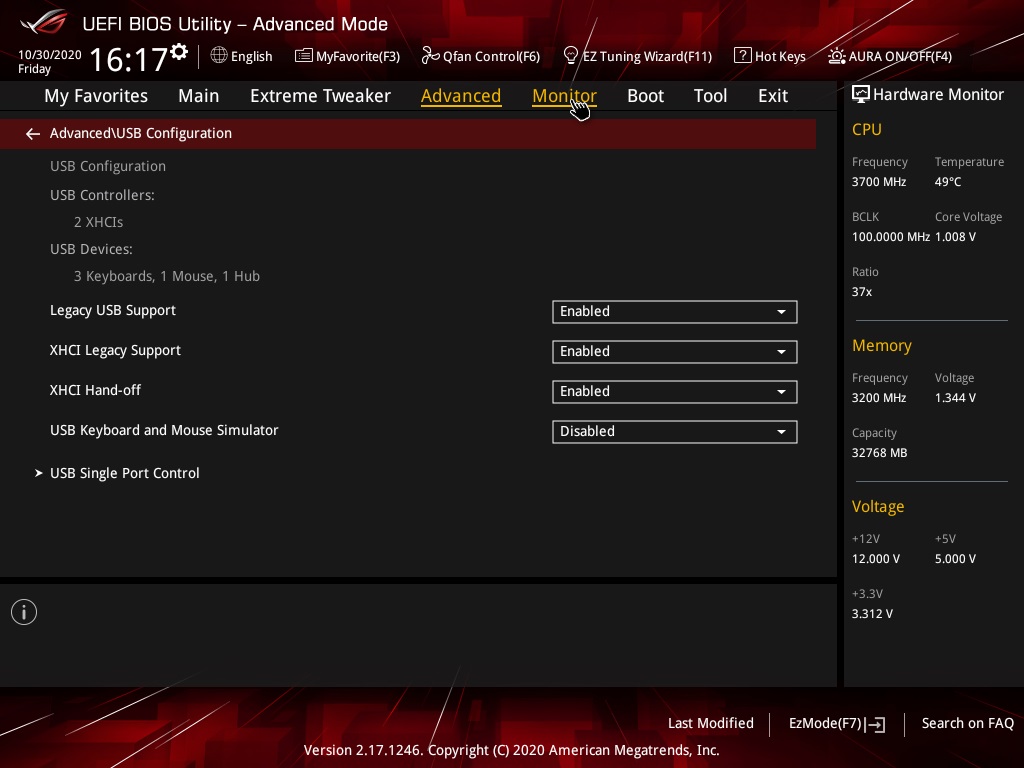

FYI, I also enable disabledynamictick .
This is a modified BIOS for X HERO 2301. Firmware via usb drive. Experiment if you like.
If you change xhci. the keyboard will not work in bios but will work in win. Reset BIOS will help.
I'll tell you on my own: I use the default settings.

ffs_

I managed to turn off "USB legacy support" and "XHCI legacy support" and everything worked in full UEFI mode, but I didn't notice any benefits, so it wasn't worth experimenting with these options.
