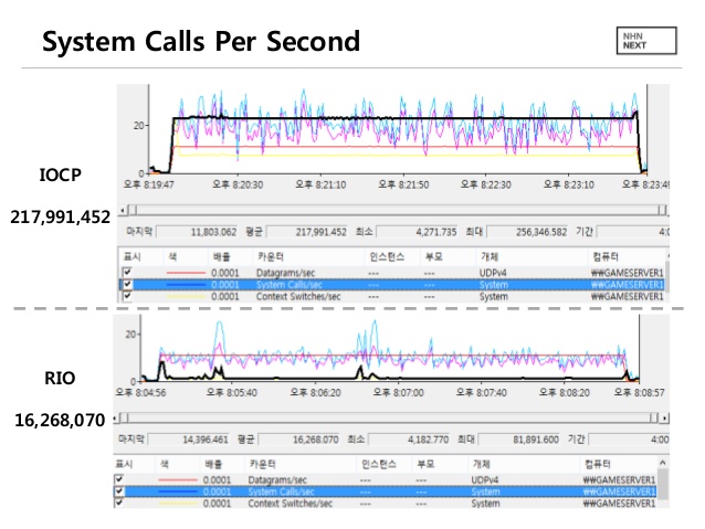

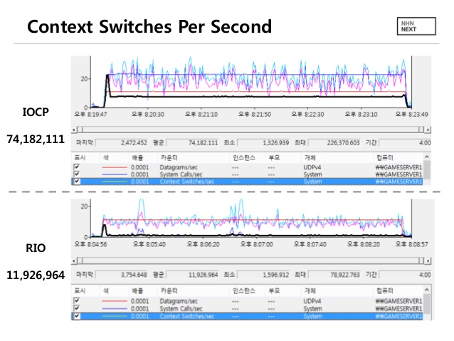

Post by schizobeyondpills » 14 Nov 2020, 15:53
14 Nov 2020, 13:55
Looking at raw input windows API, both GetRawInput and GetRawInputBuffer functions have a syscall overhead.
GetRawInputData gets the raw input one RAWINPUT structure at a time. In contrast, GetRawInputBuffer gets an array of RAWINPUT structures.
https://docs.microsoft.com/en-us/window ... winputdata
Looking at the cost of kernel call, note it is LOGARITHMIC SCALING.
https://stackoverflow.com/a/8247379
so 8000 * a syscall * usermode->kernel mode context switch is a huge problem for real-time 8000Hz, to have actual real 1000/2000/4000/8000 Hz polling it needs to be consistent, meaning XXXX.0000 or as close as possible to no jitter.
Linux has something called vsyscall ( https://lwn.net/Articles/446528/ ). And recently windows introduced registered I/O that reduces system calls for socket operations, its a must have imo to get rid of syscalls for something at 8000Hz. also no copying of buffers, it should be direct user=kernel mode shared buffer.
Windows also has I/O completion ports so maybe something like that, or Registered I/O.
https://www.slideshare.net/sm9kr/window ... red-io-rio
slide 12, notice the blue and yellow lines which drops the syscalls and context switches to very low "noise" levels.
i attached the image of slide below.
