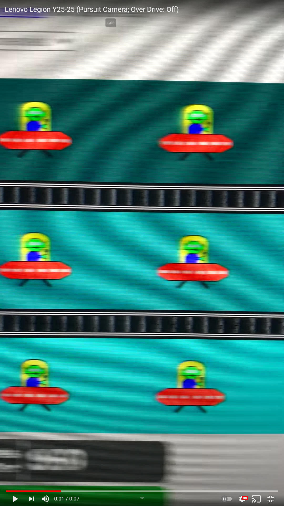

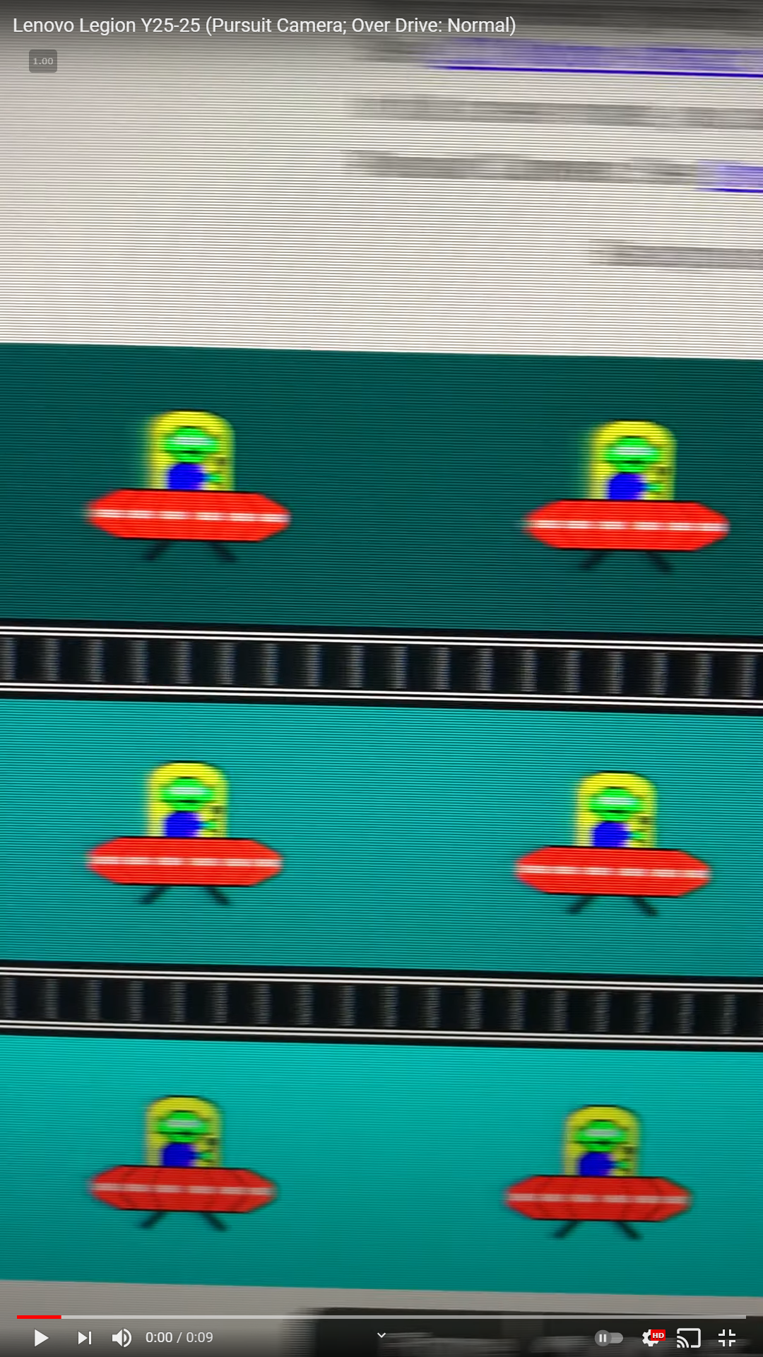

This is my first attempt at following pursuit camera guide with an iPhone:
Over Drive: Off
https://youtu.be/ZomRYcDrfPU
Over Drive: Normal
https://youtu.be/l8OXfISMPzI
I did not save "Extreme" version of Over Drive, because Ghosting was absolutely terrible!
I know that I can do better and will try to create better versions today/tomorrow. I used a built-in camera app. If anyone knows of a good third-party app for recording, please let me know!
Btw, personal observation - when playing Valorant (the main reason I got this monitor), having it set to "normal" over drive, seems to give me a bit of a better "advantage" versus it being off.
PS: I would like to try overclocking this monitor and I will post my results here.

I took the liberty of playing the videos, then pausing it, then single-stepping the frames (the "," and "." buttons) to find the best Sync Track images.
For you, from your video, I have screenshotted one of the best freezeframes of each of the two above for comparison sake.
(To get high resolution screenshots, I actually rotated my monitor into portrait mode to get in sync with portrait smartphone. That's why I usually prefer using landscape camera for pursuit photography, but don't worry about repeating this -- your videos were still good)
Enlargement of your Over Drive: OFF

Enlargement of your Over Drive: Normal
Screenshot 2021-01-18 16.16.27.png (1.51 MiB) Viewed 5203 times
Re: Any info on Lenovo Legion Y25 240Hz monitor?
Posted: 18 Jan 2021, 23:06
by fins
Chief Blur Buster wrote:
18 Jan 2021, 17:29
Thank you for this! Sorry, for causing the headache with my vertical videos :oops:
I already started looking into overclocking the monitor, but while my old (75Hz) monitor could simply be adjusted through AMD Radeon's custom resolution, when I tried to do it with this one it did not let me save, blocking me from saving with an error message. I found another more "involved" option, requiring to overwrite default frequency values in monitor drivers, but not sure if that's the way to go :?
