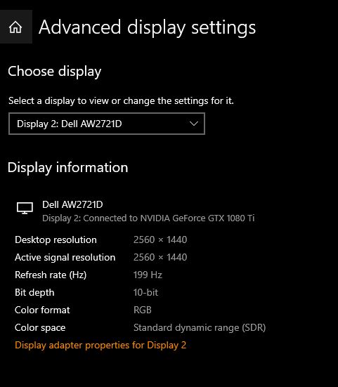

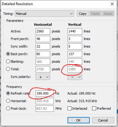

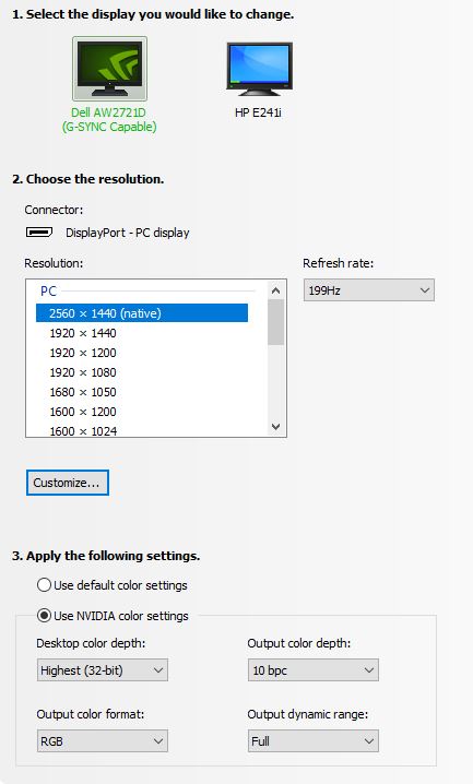

Most of you might have already noticed that 10bit is limited to 144hz and you have to stick to 8bit on 240hz.
The thing I noticed was, if I create a 199hz custom res, I can pick 10bit, but it always resets to 8bit right after applying, so I kept tweaking a bit with CRU. You can run 10bit at 199hz. Heres how to do it:
- Start CRU
- Edit your Extension blocks
- Click Add
- Select Type: DisplayID 1.3
- Create a detailed resolution
- Set Refresh rate to 199hz and change VT from 1586 to 1585
- Apply, restart driver, open up NVCP and set ur refresh rate to 199hz and 10-bit rgb
Hope this helps.

Lancast wrote:
03 Mar 2021, 04:57
- Start CRU
- Click Add
Hope this helps.
I'll be frank with you and ask you a question, how do I even see 10 bit RGB? or how do I test it if I do not use the HDR feature?
Since I tried 10bit/12bit in 144Hz and couldn't tell a difference with 8bit SDR 240Hz..
even in games, what should I look for? It's interesting though, maybe we can find a solution for 240Hz 10bit? through CRU? Maybe there's a specific tweak.. but nonetheless, this monitor is great with colors, period.. how better can it go?
