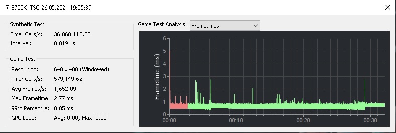

MT_
https://youtu.be/MvFxps1COnQ
It does not seem strange to you that the OS 20h2 unoptimized by your script, on an older processor and chipset with overclocking out of the box, with terrible memory and hynix timings, with ht, with running chrome and a video capture program, having 106 processes and 1400+ threads. For some reason, 2 runs in a row are whiter, and most importantly, stable frame time?
It turns out a game running on top of all this garbage that runs in the background will have a higher and more stable frame time.
Following the trends, I should create a new faith and grow in popularity, telling that exactly 8700 and 20H2 are "minimal jitter / input latency and overhead".
The funny thing is that there are sure to be those who believe in it.
This is the result with the least amount of background tasks that I can afford.

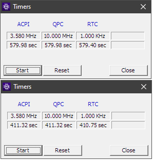

The app CPU-Z has a tool called "Timers".
Run it, play a game for some time and when you're done, all three timers should match.
If they don't, you have an issue.
I've had this exact problem for quite some time. Any ideas what causes it? I have all power saving options turned off in BIOS and Windows. I'm on 20H2 with a 9900k so not using really old hardware.
