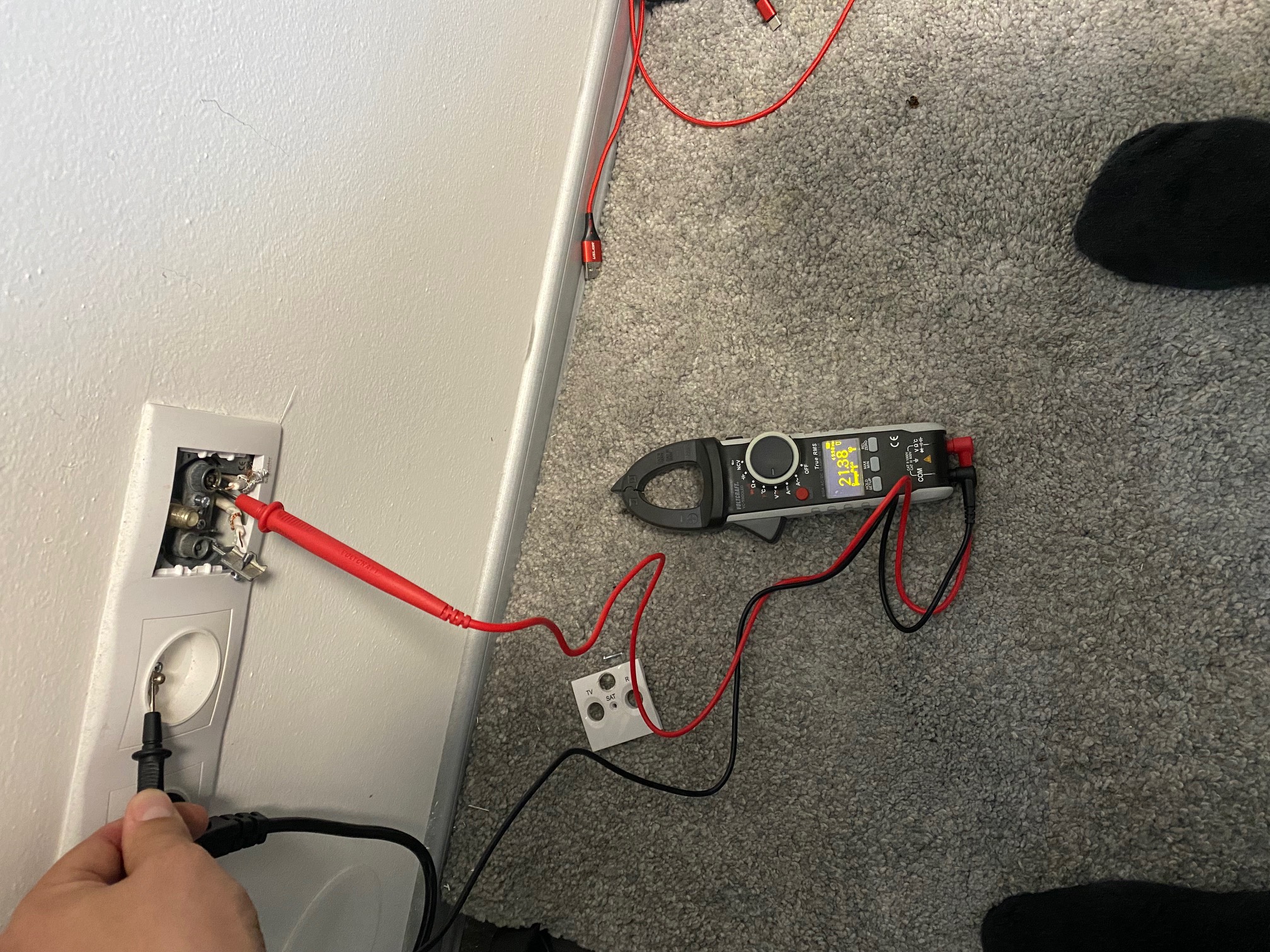

Betwen ground and zero i have 0V. Freq is all right. I spend crazy money, change meter, no harmonics so i give up mate. Mouse i floaty no hit reg… 3 diferent ISP fiber VDSL, no fix, 5 diferent PC. There is no solution boys.
You need more than an ordinary multimeter. I have 0.05V between ground and neutral, stable voltage at all times, 50Hz ± 0.09. What you need is to check wirings for radio frequency interference. Strong transceivers nearby your house/flat can lead to induction of interference in the electrical wiring. Find the radio specialist in your town and go ahead.
Well mate it was measured with 400Euro meter so there is no false number betwen ground and zero is constantly 0V. All my wire in my appartment is coper. There was one concern that i made with half answer. That i put everywhere coax cable in the wall for TV. There was measured 40V between ground and coax cable and that was wierd to me. That coax cable is not conected to anything so double wierd. A was asking why is that hapening what volatage that is and the answer was: inducted voltage the coax cable is close to elctrical cable its charging by itself it does not mean if you want light up a bulb with that 40V it never happend. The expensive meter was able to measure 12V between ground and my table or metal chair. But it never measure any voltage between ground and zero. If you have measured voltage here maybe you have diffrent issue and if you measure voltage between ground and zero you groud is not working as it have too.

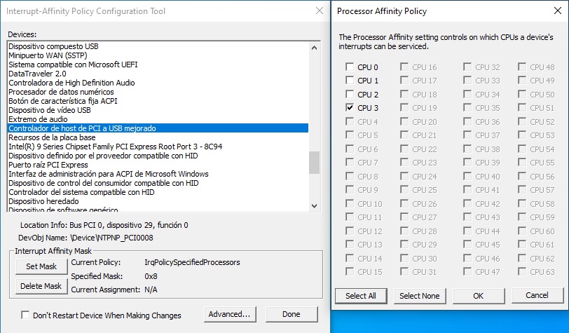

Interrupt affinity only reduces ISR/DPC and mostly changing GPU.
You are not going to get reduced input lag or more fps.
I tried this long ago and never had any benefits.
It could generate other oddities.
If a game's graphics thread gets set on cpu 3 and you set interrupts there also (GPU, mouse, whatever) it could actually make things worse.
The app let's you specify.
To see if it's working install "Windows Performance Toolkit" and run cmd prompt with admin rights.
1. cd "C:\Program Files (x86)\Windows Kits\10\Windows Performance Toolkit"
2. xperf -on base+interrupt+dpc (move mouse really fast on desktop for 8 seconds or so)
3. xperf -d C:\Users\YourName\Documents\trace.etl
4. xperf -i C:\Users\YourName\Documents\trace.etl -o C:\Users\YourName\Documents\report.txt -a dpcisr
Now check the DPC/Interrupt for usbport.sys in report.txt to see if the specified cpu has a large number in 'usec'.

Post by MatrixQW » 17 Jan 2022, 18:35
I think you are confusing me with the user Qure.
I'm not using an external hub, it's the one from my board Asus Z97-K but connected to a 2.0 port.
That's why it is using the 'enhanced pci to usb host controller'.
