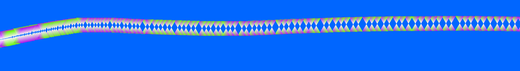

Here's some code for engines that should mostly fix the OP jitter problem without needing a 8000 Hz mouse, plus a demo. It extrapolates the mouse position: if the mouse reports position 300 at time 0, then position 400 at time 1, and now it's time 1.5, you expect the mouse to be at 450, not 400. The top triangle reports the extrapolated position, and the bottom triangle reports the mouse-reported position:
vsync copy.7z
(2.11 MiB) Downloaded 831 times
There are some other moving parts (detection of mouse sampling rate, estimation of acceleration) that are less pure and make some assumptions.
I can't see any difference on my own machine, since my mouse (Steelseries Rival 3, TrueMove Core) has a large 1.5 pixel std dev jitter at my current CPI, and my monitor is 60 Hz. So the aliasing jitter (1000 Hz mouse, 60 Hz screen) is overwhelmed by the mouse jitter.
If you are doing just-in-time vsync, this method will only reduce mouse jitter by 29%, since Windows wakes up every 1 ms, and you probably shouldn't be busy-waiting. The 1000 Hz wakeup will add its noise to the 1000 Hz mouse. That's not a mouse problem though. So I turned it off for this demo, because the GPU wakeup should be more accurate and exhibit the effect better.

I investigated the shockingly large jitter and it seems the GPU wakeup is in fact not accurate like I assumed. So I added a new toy to the demo: hold right click and it will draw green and purple triangles, with the color flipping each frame. If you drag it fast from left to right, you will see blue diamonds in the center. Unevenness in the diamond sizes means the mouse has jitter. This is a pretty good way to visualize mouse jitter.
There's 1 px quantization in the mouse position, so if you're dragging too slow, you'll just be seeing the quantization error.
vsync copy.7z
(2.11 MiB) Downloaded 839 times
Also, this demo turns off the GPU double-buffer wakeup mechanism (that almost every game uses) and goes back to JIT vsync. Is it really true that every game has a 1 ms range of wakeup times? That seems a little large...
