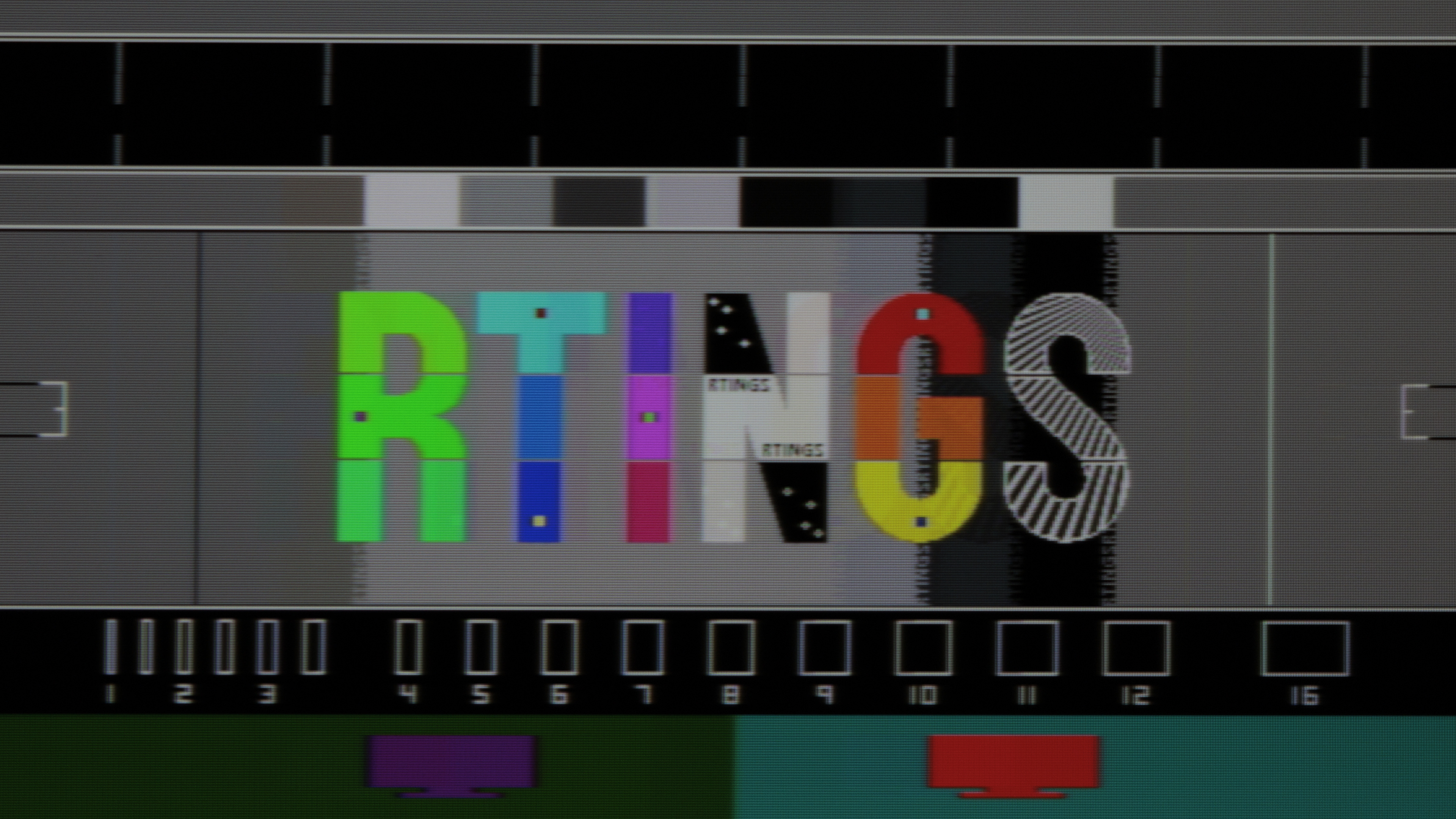

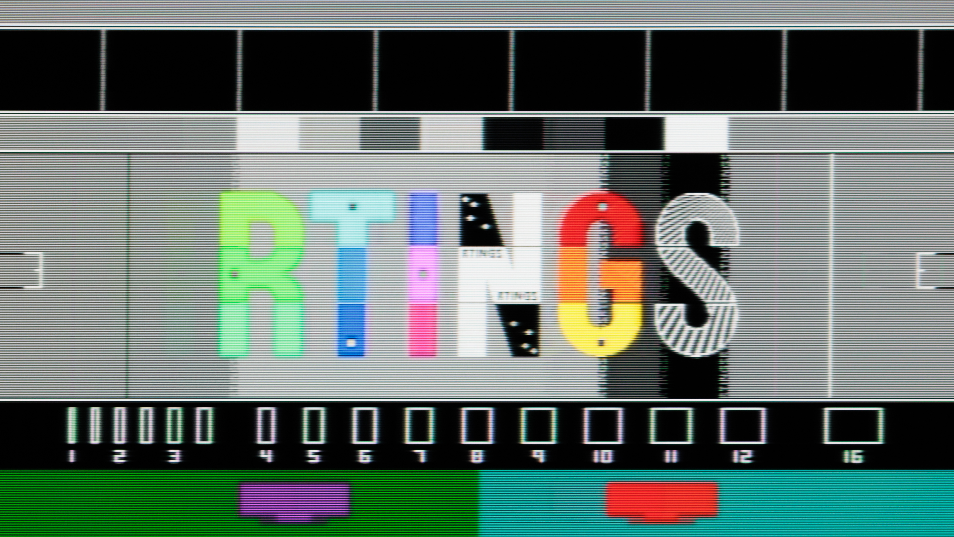

RTINGS early-access review for the Bravia 9 II dropped today (65" model tested) and the BFI pursuit shot is beauuutiful.
CAD tests are pretty good too, they compare well with the best Samsung Mini-LEDs.
I am so bummed that these have a matte coating because otherwise they appear to be pretty awesome.
Actually it appears the 115" model has a glossy finish, but I worry about strobe crosstalk at this size.
Not to mention I would need to reorganize my entire house and get a really nice end of year bonus before I even begin to consider pulling the trigger on that one...
But there's hope, people. Sony's BFI greatness is back, at long last.
Edit: adding the QN90F pursuit shot to represent what Samsung's high-end Mini-LEDs can achieve with BFI + lowered brightness, as we currently have no evidence that Sony TVs can increase motion clarity by doing the same.
Bravia 9 II.jpg (2.9 MiB) Viewed 810 times

brownvim
Posts: 228
Joined: 22 Jun 2020, 04:15
Re: Low MPRT strobing LCD TVs (mostly Samsung, some Sony - lots of RTINGS BFI Test image comparisons)
Post by brownvim » 14 Jul 2026, 17:55
Not bad, thanks for the pics. What’s the brightness of both?
I always liked Sony’s motion for films and sport. Would be interested in checking one out for console use.

JimProfit wrote: ↑
14 Jul 2026, 17:24
That's somewhat absurdly clear for a 120Hz LCD TV @ 1920 px/s.
It rivals the DyAc2 photo I've posted here in terms of effective motion clarity.
I'm somewhat against 65"-sized TVs, but that's impressive.
Did RTINGS mention what brightness the TV targets?
I assume local dimming is disabled when MBR is enabled?

kyube wrote: ↑
14 Jul 2026, 17:59
JimProfit wrote: ↑
14 Jul 2026, 17:24
Read my post prior to the one where I posted the two screenshots. We don't know about inconsistencies in brightness settings, the exact settings used for the BFI pursuit shots is undisclosed.
Therefore, I chose to put their QN90F pursuit shot because I know my QN90D and QN95D can get close to that by lowering the brightness once LED Motion (BFI) is engaged and it's likely how the QN90F pursuit shot was taken anyway judging by how dim the shot is.
MPRT on Samsung's Mini-LEDs is better than the new Sony RGBs unless proven otherwise, however it's also pretty clear that the Bravia 9 II has amazing qualities that would arguably compensate for the potential advantage in motion clarity. To me the matte screen is the deal breaker but who knows what the future holds.
