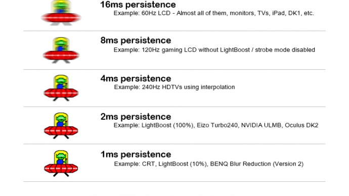

To be clear, pixel inversion is describing how monitors flip the electric polarity of each pixel in order to prevent damage that would happen if the polarity was constant over a long period. There will be subtle differences in intensity depending on the voltage and the differences will show up in the inversion pattern used by the pixel inversion method. Usually this is very VERY subtle on most monitors and in my experience I have never been able to see it normally or using pixel inversion pattern test images on any of my monitors in the past 5 years. It would be possible for it to be a component of general blurring however compared to pixel response and sample and hold based bluring it would probably account for less than 5% of the total effect if even that.
No doubt when you say pixel inversion you are talking about the inversion pattern used by 6 bit frc. 6 bit frc allows high refresh monitors to use 6 bit pannels and reproduce 8 bit color by quickly alternating between 6 bit values. The alternation would happen over 4 frames so wost case it would be a 60hz fluctuation in color that would at worst case be about 1/64 of the current contrast in brightness difference. In practice it can be noticeable to the human eye and could be considered as a factor in blur or distortion. However it as well is subtle and noticing it usually depends on specific conditions where the eye and brain can process visual information on the sub 1/60th of a second time scale. To most it will either not be noticed at all or will be so subtle when it is noticed that it doesnt bother them. I personally welcome having 8bit color on my 240hz as my old 144hz was a 6 bit pannel with no frc and the difference in having 4 times as many shades of red green and blue for a total of 64 times as many colors is a nice imporvement.
If you are using gsync and dropping to very low frame rates then the frc inversion pattern may be more noticeable however it is still introducing a relatively small amount of distortion compared to the motion blur we measure.
I think yehaw you are just seeing the difference in sample and hold blur due to faster pixel response times on the 240hz. It is as chief has said that with 24hz content, bluring is actually needed in in the content itself to hide the sample and hold blur from the human mind. With the 240hz you are actually seeing faster pixel response times and so when your framerate drops below 240fps you are able to notice sample and hold blur that you were not able to see before with slower pixel response. It's all part of the tech. Its just like if a 24hz movie used crystal clear images durring fast motion, you would be able to notice the individual frames more easily.

The only way to reduce motion blur caused by sample-and-hold, is to shorten the amount of time a frame is displayed for. This is accomplished by using extra refreshes (higher Hz) or via black periods between refreshes (flicker).
