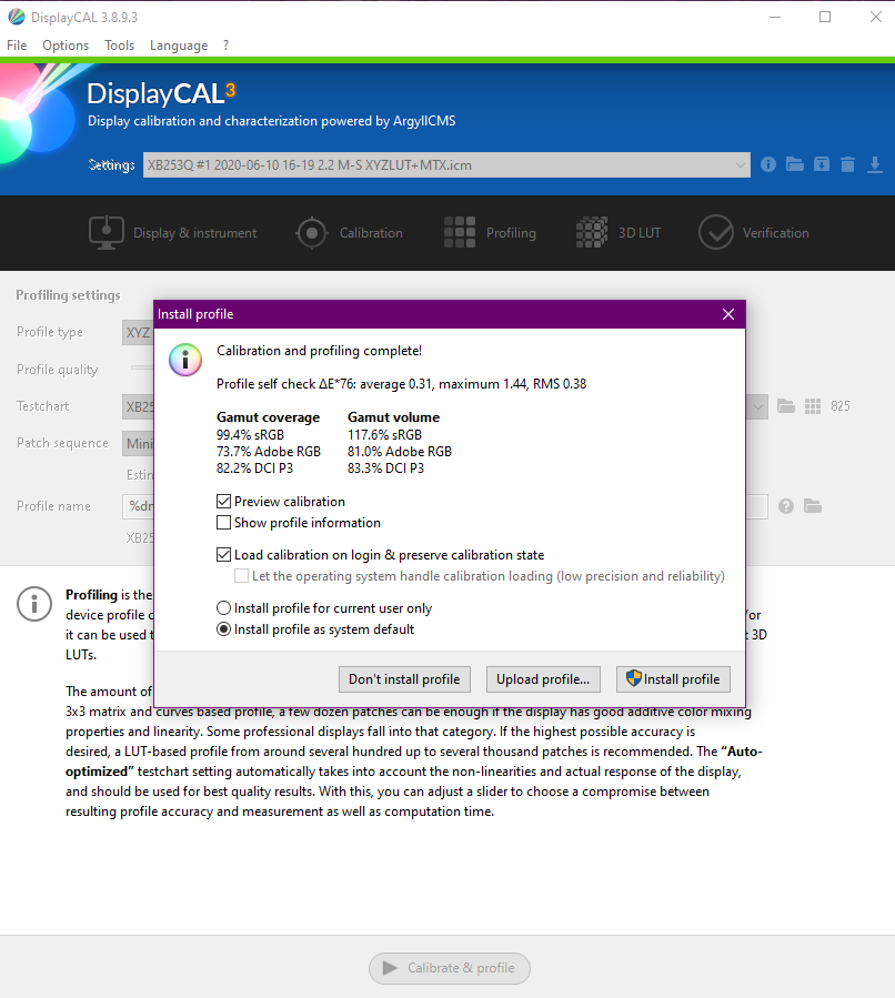

That is odd, I would get a replacement for sure. I have no such issues at all. In fact I just did my second calibration for the monitor and I am getting these results!
2ndcalibration1hr (2).png (76.31 KiB) Viewed 11581 times
