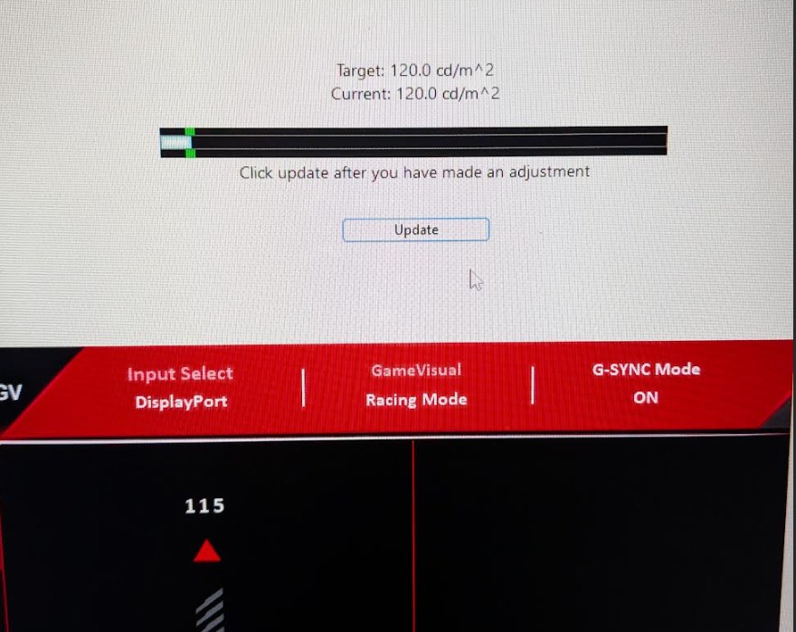

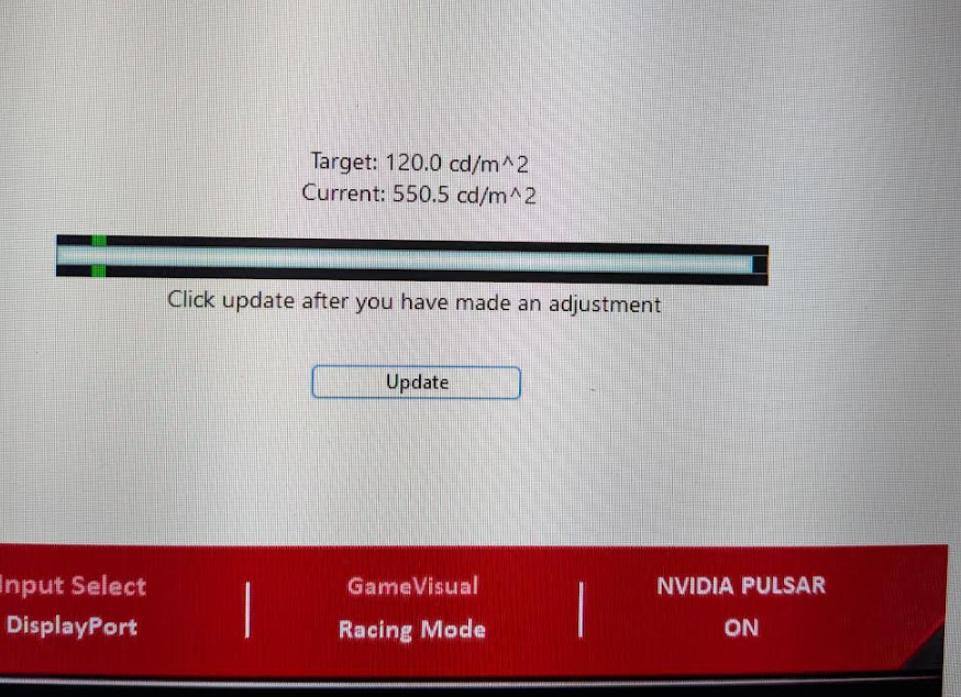

Post by MSIfanboy » 03 Jun 2026, 04:14
daviddave1 wrote: ↑
03 Jun 2026, 03:12
Does anyone have a good icc profile to share?
https://www.mediafire.com/file/6kdwkzp5 ... c.icm/file
using spyder x, racing mode, not much difference to be honest, this monitor is already calibrated pretty good
pulsar on gets to 550 nits
Screenshot 2026-06-03 191658.png (895.61 KiB) Viewed 1304 times
Screenshot 2026-06-03 191644.png (709.29 KiB) Viewed 1304 times
