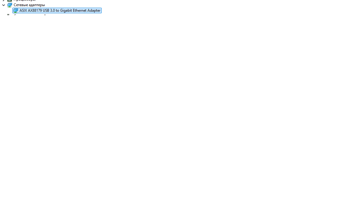

Guys I've bought the TP LINK UE300 USB Ethernet adapter but it is actually a ASIX AX88179 chipset, what the difference between them? why u saying do not buy the ASIX version? I've connected this adapter into USB 3.0 port and already see the difference in hit registration and also mouse feeling ( btw floaty mouse is still not fixed 100%) my specs are below:Misha1337 wrote: ↑23 May 2025, 13:42amc wrote: ↑20 May 2025, 14:02What version of TP-Link UE300 USB do you have?Master_Tinkerer wrote: ↑31 Mar 2025, 16:12WOOOOWWWW!!! OH MY GOD! THANK YOU!!!Ku6epgeg wrote: ↑23 Mar 2025, 05:42I came across this topic by accident. I also have a built-in realtek 2.5, and I also see a delay in CS2. I bought a 1 GB realtek usb and it has the lowest input latency with Windows 11 drivers. I don't understand why this is so, the usb card lacks settings such as interrupt moderation and flow control, as well as receive and transmit buffers - 16 and 18. Can anyone explain why this is so? Why is the delay minimal on the usb network card? And it is on windows 11 stock drivers. If you install the latest realtek drivers, then flow control appears and the receive and transmit buffer is already getting 37, CS2 is starting to get worse. So the best option for me at the moment is a usb 1gb realtek on windows 11 stock drivers.
I bought a TP-Link UE300 USB ethernet dongle and it's really important to use the oldest drivers possible that get automatically detected at first (before any updates are applied and newer versions are added). I think I finally fixed my input lag after all of these years, I can finally hold angles on faceit. Thank you so much <3
I think it's better to leave the TCP/IP settings on default, for some reason it's worse for me when I disable all of the offloads.
Don't buy the 5.2 version because it's using ASIX chipset not realtek
CPU: 13700KF
MB: Asrock Z790 PG Riptide
RAM: DDR-5 DIMM 32 GB 6000 MHz Team Group T-Force Delta RGB, 2x 16 GB Kit, Black, BOX (XMP activated 6000 Mhz)
PSU: 1000W MSI MPG A1000G (NO PCIE5)
- tplink ue300.png (8.18 KiB) Viewed 15018 times
