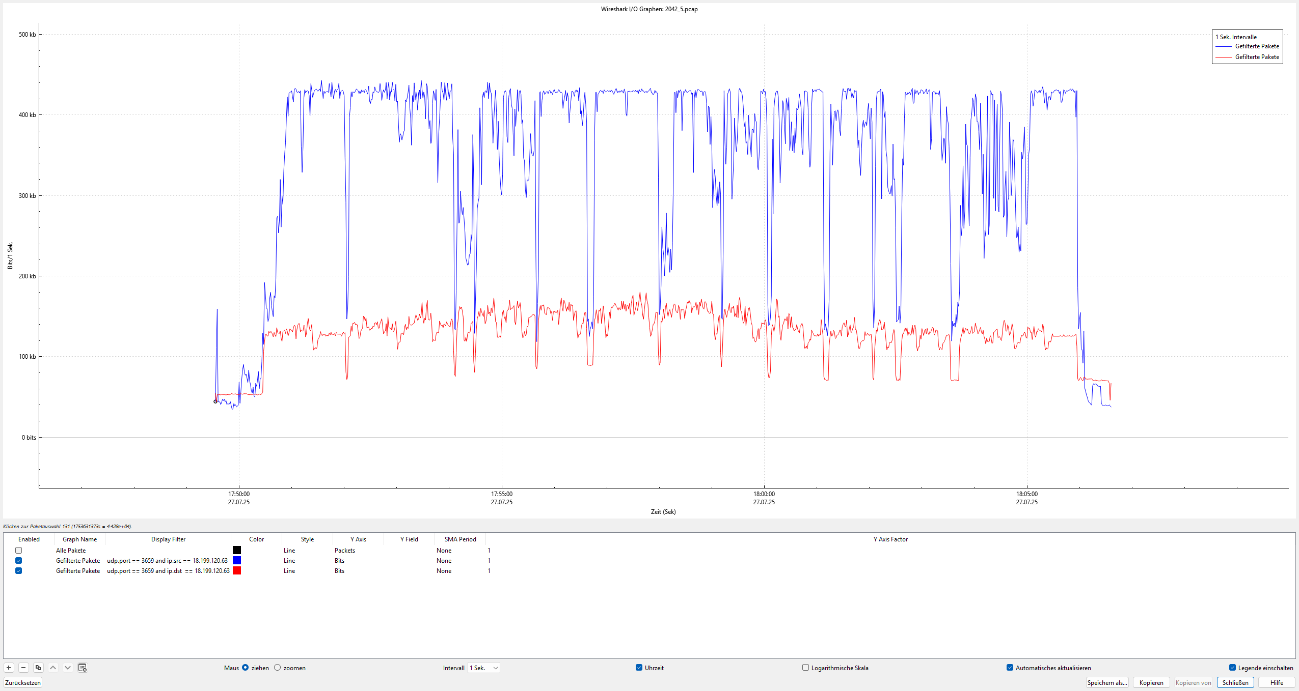

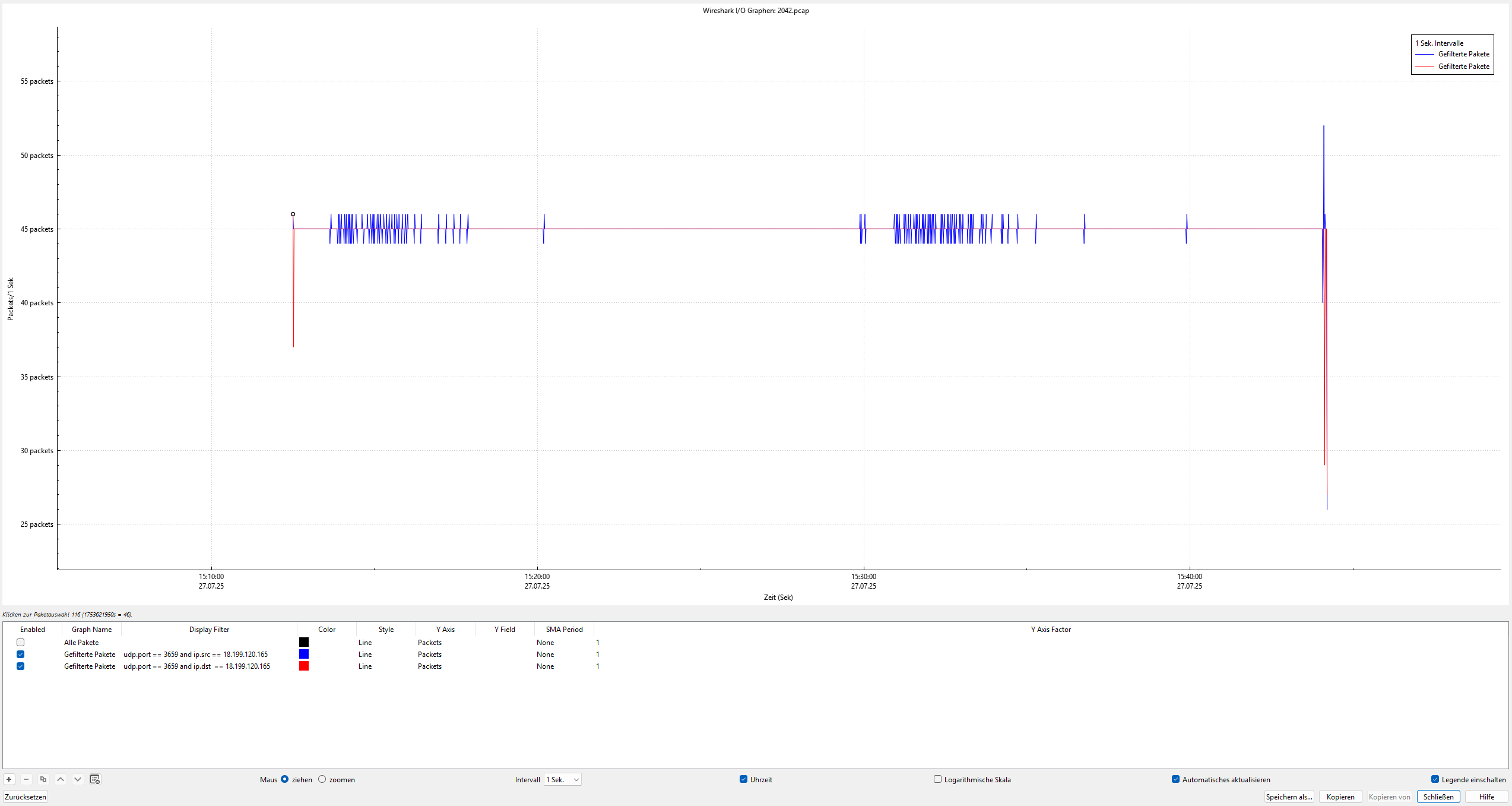

These are my thoughts exactly.
I just played, but I don't think it's useful for analysis.
- Hitreg was okay (not good)
- I can't peeke anyone (surprise)
- Anyone can peeke me (surprise / Ferrari mode)
- It's a rollercoaster (sometimes everything works normally, then it doesn't, then it does, then it doesn't...)
Screenshot 2025-07-27 154946.png (252.36 KiB) Viewed 1052 times
Screenshot 2025-07-27 154704.png (86.35 KiB) Viewed 1052 times

LaggyTyp wrote:
27 Jul 2025, 08:53
It absolutely is! Save this capture for now and put it aside. You said previously that there are rounds where the problem is gone completely. Wait for such a round, and then start another capture.

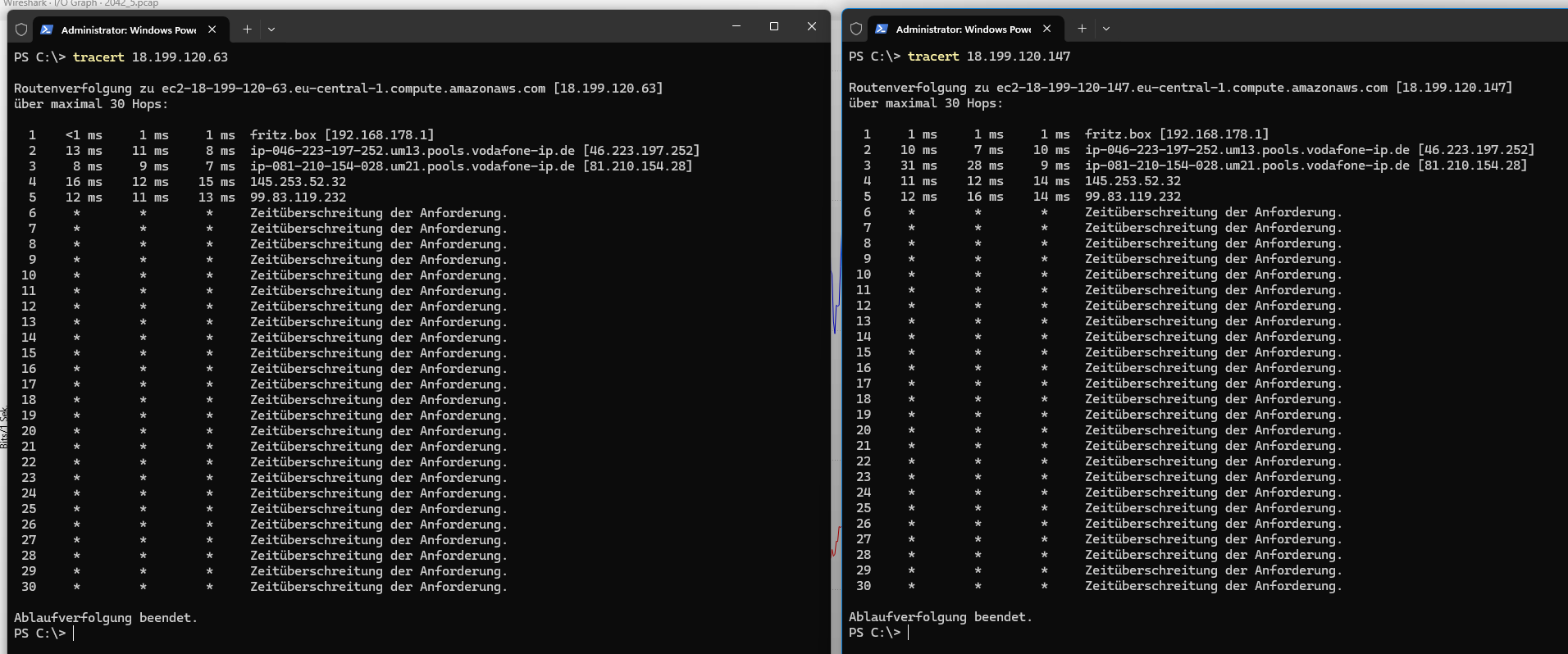

Open a CMD / PowerShell and type this:
tracert 18.199.120.63
Then, do:
tracert 18.199.120.147
At one point, all the requests will time out. This is normal because the server discards ICMP packets. Don't worry about that. You can abort the test with CTRL + C.
Screenshot both of them and post the results here.
Screenshot 2025-07-27 183010.png (165.09 KiB) Viewed 991 times
Re: No FPS gaming possible
Posted: 27 Jul 2025, 11:39
by ChristophSmaul1337
Looks fine to me. That's a great result if we assume that the 6th hop is the destination. It's the same route for both servers, so this can't be the difference between the "normal" and terrible round.
