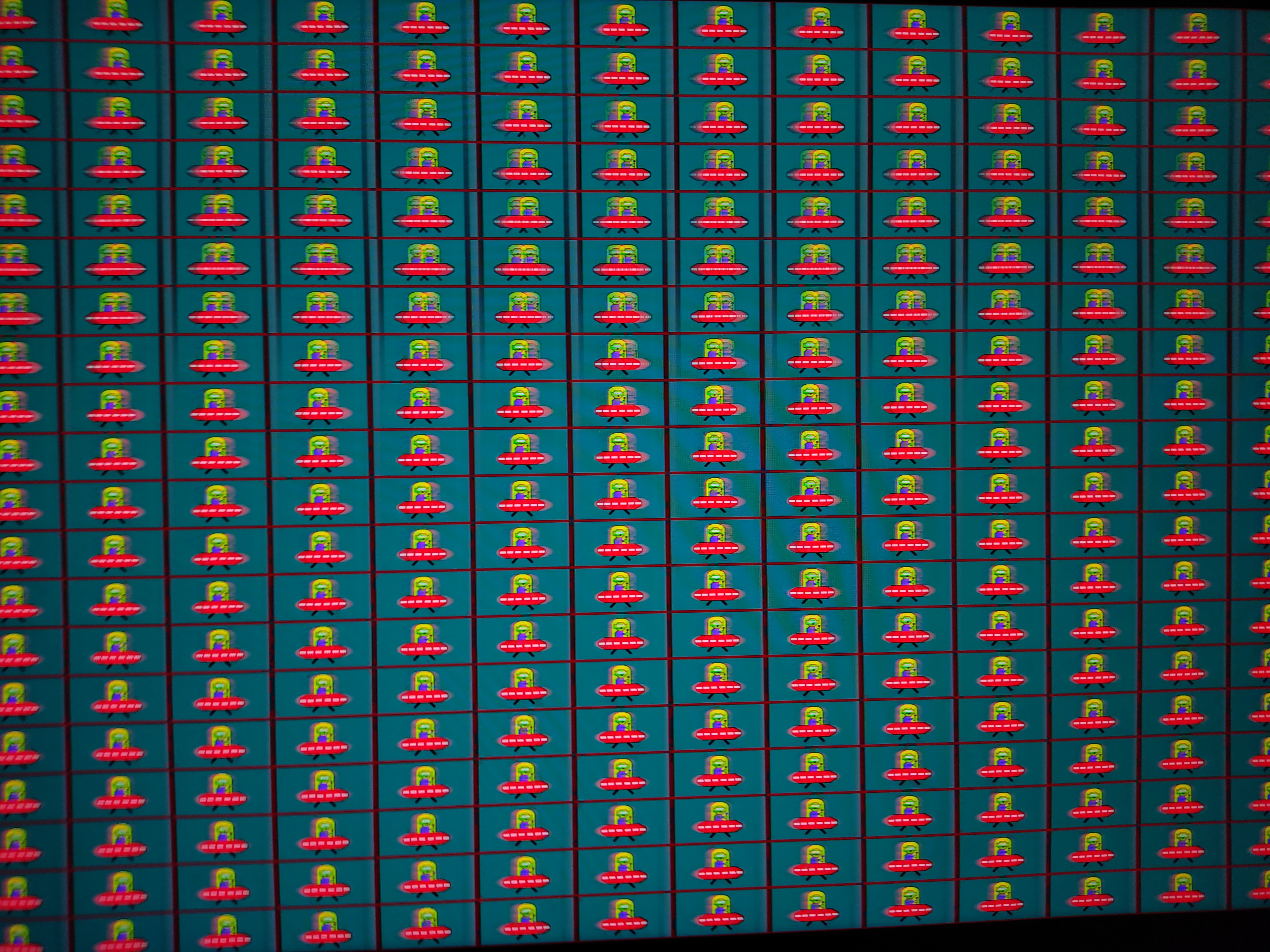

Here's something to note with single strobe 60Hz and wide gamut KSF panels specifically. Red ghosting becomes too aggressive at such low refresh rates. So beware. KSF-free panel is required to not have these issues.
This is M32Q single strobing at 60Hz (inside bugged vrr strobing mode)
Overdrive OFF, aim stabilizer at middle screen, 960pps

I can't recommend using this bugged mode. It's too dark (~100 nits), it flickers if frame rate varies, it naturally flickers due to low 60Hz refresh rate, and the ksf decay is distracting. Scaler doesn't allow large VT mod like XG2431 so crosstalk isn't great either. I also can't guarantee this bug will work for everyone.

Have you tried a ToastyX DisplayID extension block to try to swap Front Porch and Back Porch (use ultralarge Front Porch versus ultralarge Back Porch), to see if it artificially shifts the crosstalk?
Some displays keys the strobe flash based on the location of the VBI boundaries (e.g. the boundary between Sync and Front Porch, or the boundary between Sync and Back Porch). Those models can have strobe crosstalk tricked to shift simply by moving the ultralarge value to a different section of the VBI (porch or sync).
This will not work if the strobe flash is keyed to the beginning or end of the visible resolution, it only works on models whose strobe flash is keyed on one of the boundaries between two different VBI areas.

No matter what combination I do it doesn't shift crosstalk. Changes do get applied as amd panel reports. I assume its keyed to beginning or end of resolution.

Ah, yeah, no strobe-phase hacks seem available externally.
Thanks for trying, though!
