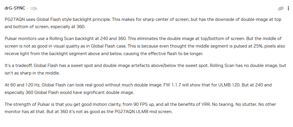

i dont understand this post, Pulsar mode aside, my benq and asus both with rolling scan doesnt have any issue being clear despite same tech

liquidshadowfox
- Posts: 288
- Joined: 05 Nov 2020, 14:03
So the reason they said they wouldn't consider changing the pulse width to 12.5% is because quote
"12.5% pulse width for Pulsar. Unfortunately, a lower pulse width doesn't help with the Rolling Scan 240 and 360 modes, sharpness quickly becomes limited by crosstalk, not pulse width"
Then someone complained the clarity is worse than the PG27AQN despite the red phosphor and it was said:
"PG27AQN uses Global Flash style backlight principle. This makes for sharp center of screen, but has the downside of double image at top and bottom of screen, especially at 360.
Pulsar monitors use a Rolling Scan backlight at 240 and 360. This eliminates the double image at top/bottom of screen. But the middle of screen is not as good in visual quality as in Global Flash case. This is because even thought the middle segment is pulsed at 25%, pixels also receive light from the backlight segment above and below, causing the effective flash to be longer.
It's a tradeoff. Global Flash has a sweet spot and double image artefacts above/below the sweet spot. Rolling Scan has no double image, but isn't as sharp in the middle.
At 60 and 120 Hz, Global Flash can look real good without much double image. FW 1.1.7 will show that for ULMB 120. But at 240 and especially 360 Global Flash would have significant double image.
The strength of Pulsar is that you get good motion clarity, from 90 FPS up, and all the benefits of VRR. No tearing. No stutter. No other monitor has all that. But at 360 it's not as good as the PG27AQN ULMB mid screen."
