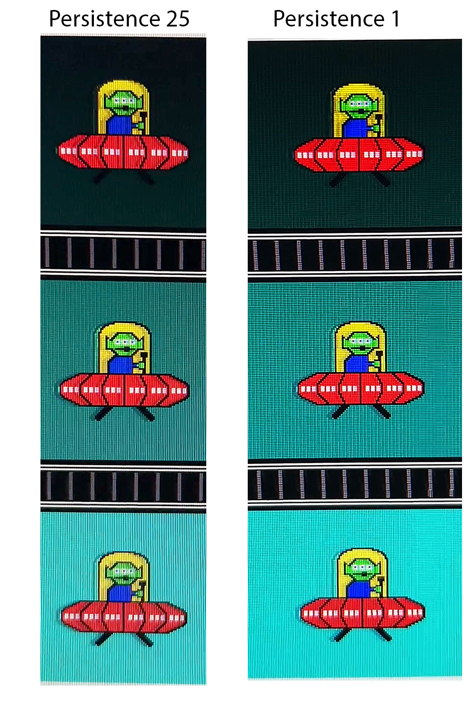

I tried to do testing wether Strobe Calibration Utility "Persistence" setting does anything apart from changing brightness on XL2566K. It does not seem to actually vary pulse width of strobing - or atleast it does not have a visual effect on clarity if it does. If anything, brighter looks a tad cleaner.
