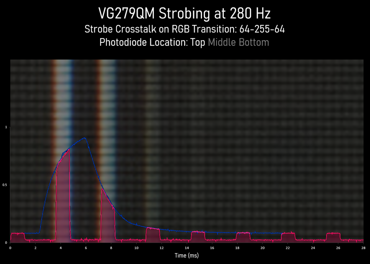

Yes, OLEDs are crosstalk free over whole panel but not only because of fast response. LCDs have a backlight so they work a bit different. On LCDs crosstalk is caused by:
1. Scan-out vs backlight interference
2. Pixel response
Due to nature of displays updating the frames from top to bottom image gets skewed (for preview check testufo.com/scanskew and use 60Hz to amplify effect) and unlike OLEDs most LCDs have a backlight which only does instant off/on periods to reduce blur. Black periods do not follow the frame scan-out like on OLED therefore are not in sync. So this instant backlight vs non-instant scan-out interference is what we call strobe crosstalk. On top of this if pixel response is slow u get faded or extended crosstalk (more crosstalk). Display can end up showing multiple frames. https://www.limscave.com/media/limscave ... sstalk.jpg
Notice fixed backlight off/on periods and variable transition position caused by scan-out:
Strobe Crosstalk APNG.png (1.21 MiB) Viewed 10157 times
Image Image
Source: https://www.aperturegrille.com/reviews/ ... -Crosstalk
Btw AW2521H can strobe at 60Hz with a simple trick - viewtopic.php?p=82006#p82006
