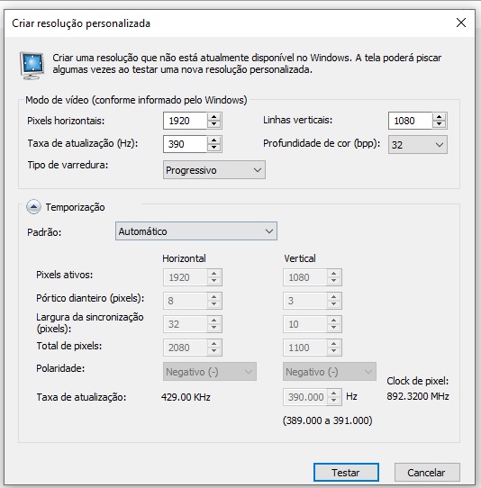

What I did was go into the custom resolutions and see what timings they were giving me on automatic with the monitor's default OC settings. Then I went back to 360hz by turning off the OC in the OSD, I created a custom resolution of 390hz with the same timings and polarity settings and I tested it and everything worked, after that I left the OC on the monitor on. The monitor didn't blink even once, no ficker so far. I'll leave the print of how the custom resolution turned out. This print is of the timings I got through "390hz native monitor". Then I created a custom one with manual times and put the same settings.Could I be missing something by this regarding the "overclocked native" 390hz of the monitor itself? Is there any way to improve further? Thanks
Sem título.jpg (80.11 KiB) Viewed 12865 times
