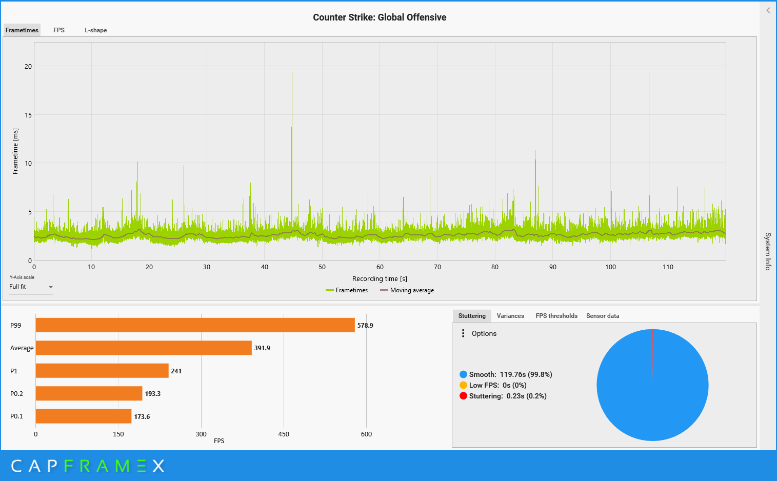

identical settings, fps_max 500, staring out mirage window on a dallas server with 14~17 people at the time.
w10 servers - just drivers installed, double clicked existing steam.exe
w10 servers.png (84.6 KiB) Viewed 11090 times
w10 pro - some tweaks here and there (nothing hardcore like I would do on w7, just disabled background stuffs)
w10 pro.png (88.95 KiB) Viewed 11090 times
