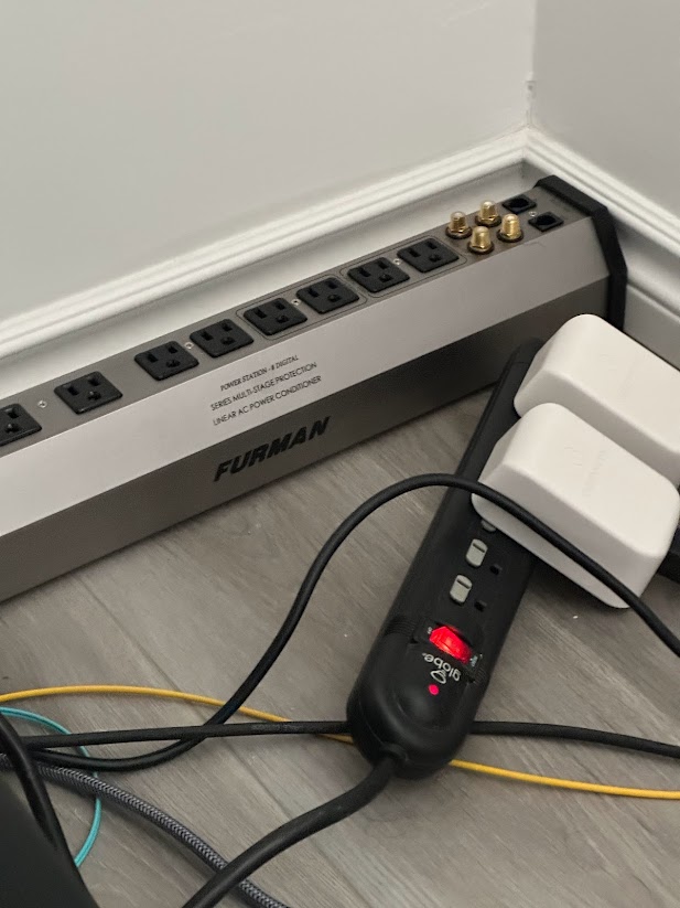

Post by KingAzar » 18 Feb 2023, 14:25
I received the Furman PST-8D and the noise reduction with both filters is the same VS a regular power bar.
Regular power bar + 2 filters even get a little bit lower mV around 12 vs 17 on the Furman PST-8D. Now when we talk about noise once my PC is on, it remains the same, I guess I will order 2 other filters just to play around
Just to give a quick recap for anyone who just got here
My line noise is usually around 90-200mV while my Pfsense box and PC are OFF.
The noise emitted by my computer was at 1500mV, then I replace my PSU from Corsair HX850 to HX1200. This reduced the noise on the line to 600mV. Since my mouse became more responsive. I ordered two Greenwave filters and now my line noise in my office goes down to 12mV when the Pfsense box and PC are OFF. With 2 filters plugged in, now the noise emitted is between 80-120mV when both devices are ON.
So far my game experience has been good. My mouse input lag has been away since I started changing my PSU and now I'm just trying to make things a bit sharper. I will return the furman power conditioner.
